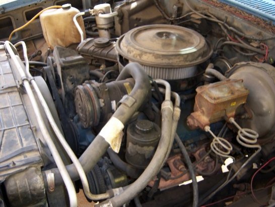

Mine has the short one. This is an 86 Configuration with an HR6.

Mine is the shorter round one. I used to work in a salvage yard and when they came out we called them radial compressors.
47,215
9,497
You probably have many refer to as the Pancake Compressor. It's much thinner than the longer ones.
