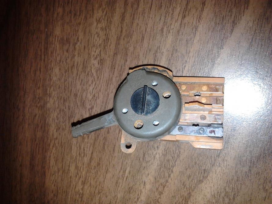

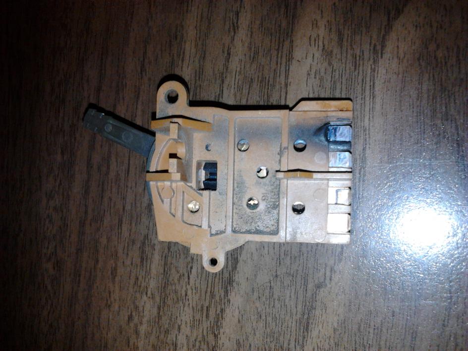

You were definately right... I kept using it till the bitter end..hoping it was just dirty contacts (I really hate cracking into my dash, a lot of my screw mounts are brittle and cracked.. half the dash screws are stripped).. ... but it finally went..
actually it stayed in either extreme high, or extreme low speeds these last few days.. when it did decide to kick on.. the middle two selections were shot.. oh well not bad for 27 years of use..
Think it was a bad switch??? LOL
