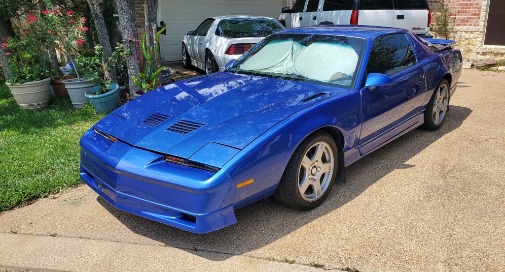

Well, rear bumper fell to some bad prep and has to be repainted with some possible cracks repaired with 3m adhesive first. Otherwise very dusty and somewhat extremly slowly coming along. Still have heads/cam to install and paint the engine bay black at some point as well.

I completely forgot that you painted the car blue!

Front side pieces and rear bumper still left to finish.
