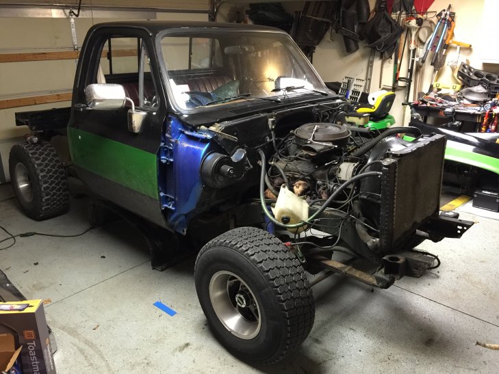

I'm in the process of gathering all the goodies to do a resto an LS swap on my 87 V10. My truck currently has a 5.7 TBI 700R4 208 combo. I've already purchased a 99 LM7 engine with harness, ECU, and all accessories. I have done an immense amount of searching and research but I'm still on the fence about some things, chiefly of which trans to go with and the pros and cons on each. My plan is to restore the truck, do the drive train swap, and run it for a year or so to see whats what. At that point I would like to install a T70 turbo. This where I know the 4l60 is not going to survive, and feel I need to go 4l80. I understand either trans will need a VSS signal. The 4l60 has its pros for me because I can (if my research serves me) reuse both drive shafts, and either modify my current 208 T-case or find a 241c w/vss. With the 4l80 I'm not exactly clear as to what else I'm going to need to make it happen.
I'm assuming my 99 ECU will control the 4l80.
-do I need to purchase a trans of the same year, or will any 4l80 do?
-will my t-case options change?
-will drive shafts still work?
Basically, what are the differences between the 4l60 and 4l80 swap parts/install wise?
Thanks in advance!!!

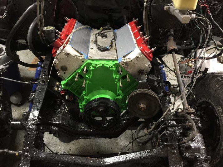

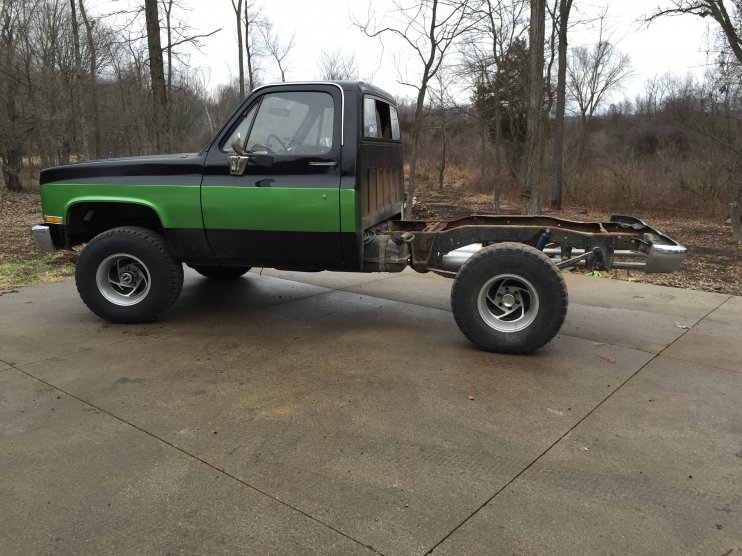

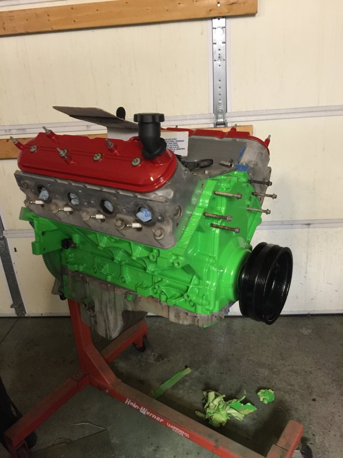

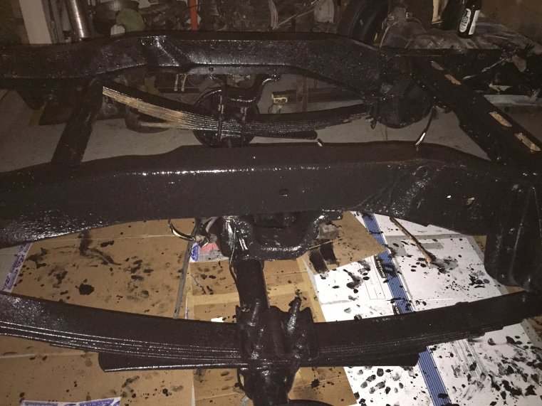

Haven't posted any progress and figured it was time!

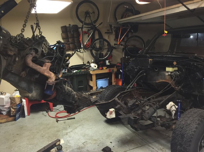

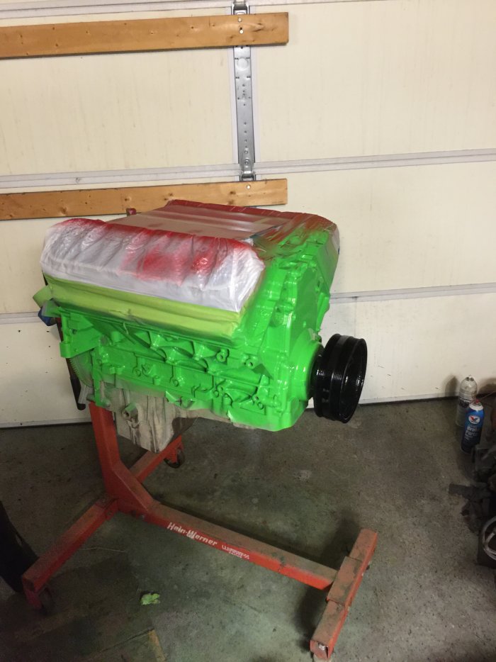

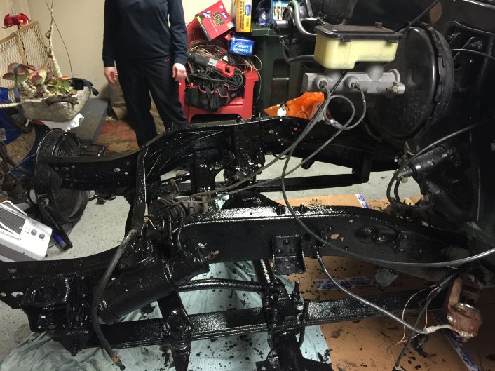

few more!

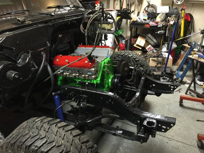

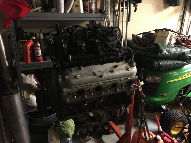

A bit more progress!!

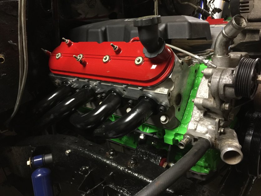

is that just the shipping paint on the headers? looks too shiny any thing else. Be ready to burn off the shipping paint by running it, then put on some more permanent. On the driver's header I had to move the O2 sensor bung b/c the original put it in the middle of the shackle
looking great
throttle out
Sep 10, 2015
98
58
Michigan
Sam
V10
5.3 LS
Shipping paint for sure lol. Gonna paint em neon orange lol, JK

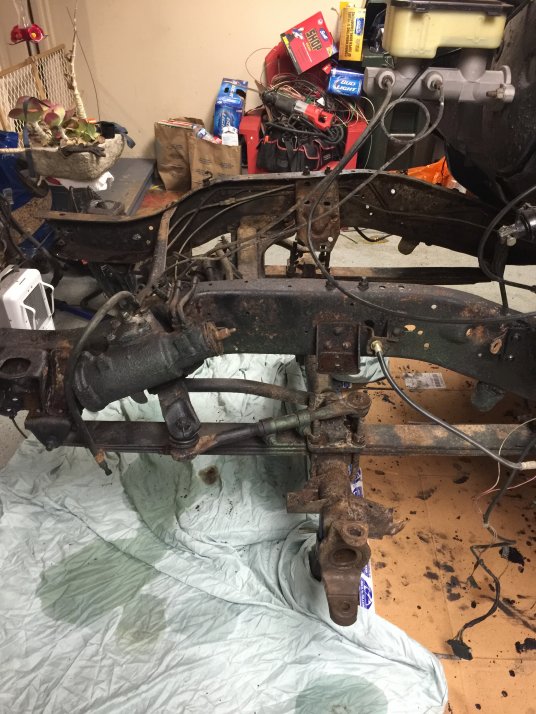

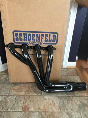

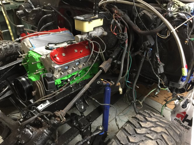

Finally made some more progress!!!
Got my front axle back together with new Moog parts. New sending unit with EP381 fuel pump. I decided to cut the barbs off the ends of the sending units feed, return, and vent lines and use compression fittings to convert to -6an. -6 steel braided line with cushion clamps. Bowtieoverdrives TV setup for my 700R4. Energy suspension motor mounts. Dirty Dingo plates for the engine side. The Schoenfeld 1302LS1 headers fit awesome, but i looks as though I may have to relocate the driver side O2 bung.
Scored huge on my local craigslist and found a set of Cooper Discoverer STT's in 33x12.50-15 with only 4000 miles on them for $350:party36:
Anyhow, just plugging along and wanted to share!!
Sammy
