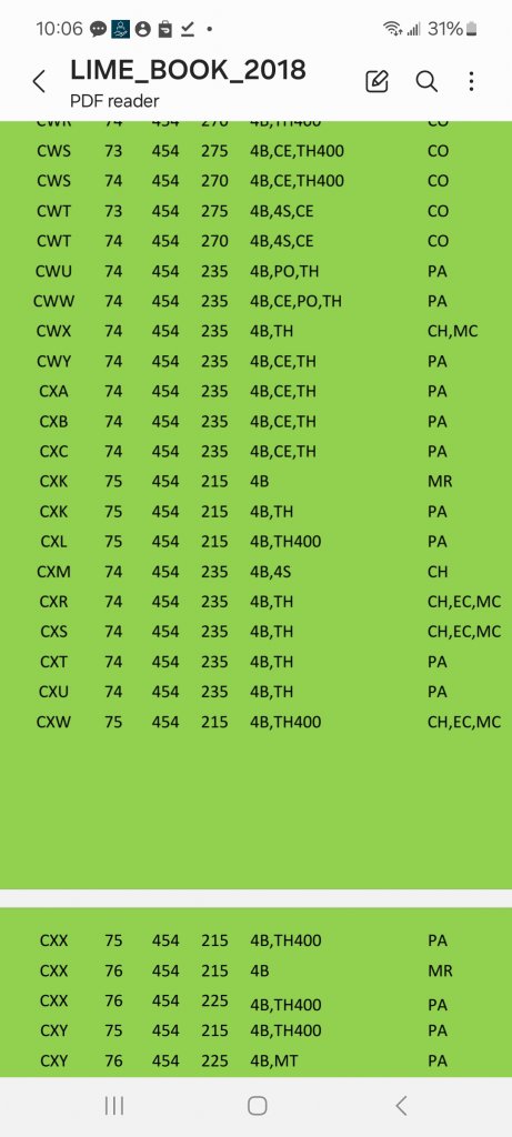

R20 Suburban
So I'm a little confused by some items on my Suburban. It's an '87 R20 454. The spid shows L19 for the engine-TBI 454. The air cleaner shows a ZKY code with what appears to be a Q-jet layout. Currently has Holley Sniper setup. Annnd in another twist- it was originally sold in Maryland, I bought it from a guy near Indianapolis who said he got it from Arizona a few years ago, and there's this receipt from Maryland circa 1989 for a 1974 454 with my VIN on it??? I need to check the block code. I know it's 37 years old and anything could have been swapped, but Q-jet on an '87 454?

Verify your cxa code. That does come back to a 1974 California Emission 4bbl 454 Automatic transmission chevrolet
