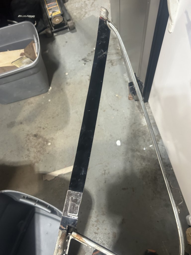

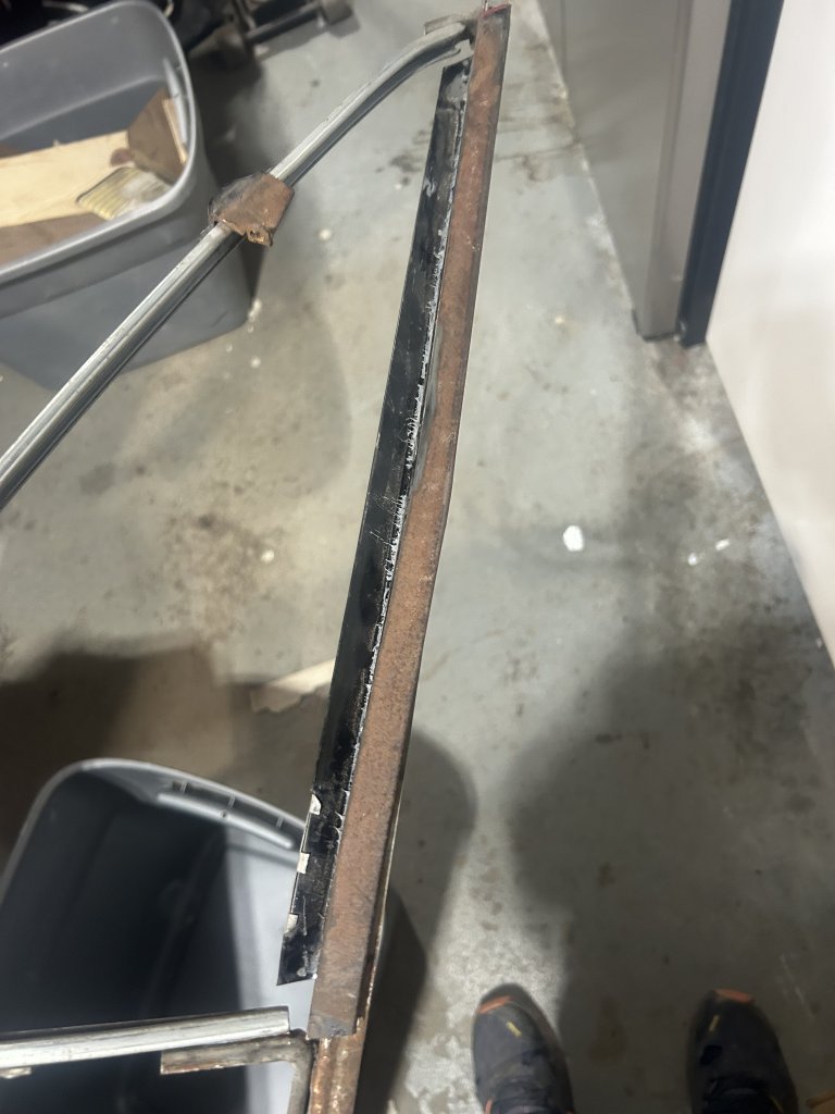

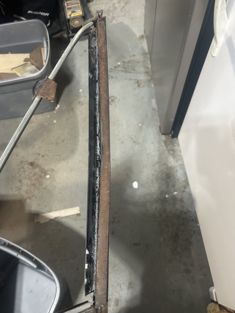

Does anyone know if you can buy this trim piece for the vent window for a 1985 c10. The inside piece is like plastic. But the outside is metal. Mine is rusty. Can’t reuse these after all the work I have put into restoring this truck.
Pictures below. Any help be greatly appreciated

No that’s not the part. If you look
At the second picture. You will see the chrome part that the vent window lock hits.

Unfortunately no, that piece is not available separately. You'll either have to refurbish that one or buy complete new vent window assemblies

IIRC Precision Ruber will restore the wing window frames and seals for a price, I've never seen them but supposedly they powdercoat the frames

I rebuilt mine on my 85 about two years ago. I was meticulous about the prep and paint. Looked good....for about a year. The paint won't stay. I would pay the $$ to have them powder coated if I did it again. Or chrome plated.

Yep, or they'll sell ya a whole new assembly ready to go. We've got them in stock last I checked

I have a whole wing window assembly for the drivers side if you're interested. Let me know.

Ok. Thanks. Didn’t think they did make them. Maybe a business for someone. Lol
