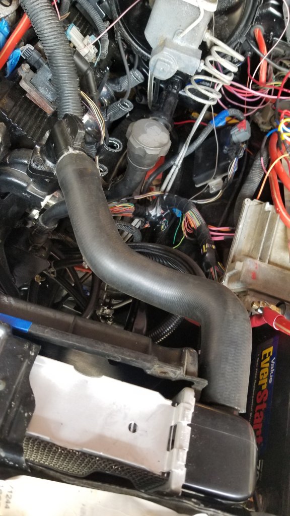

sent to autozone and found some radiator hoses that would work, had to trim them to fit.

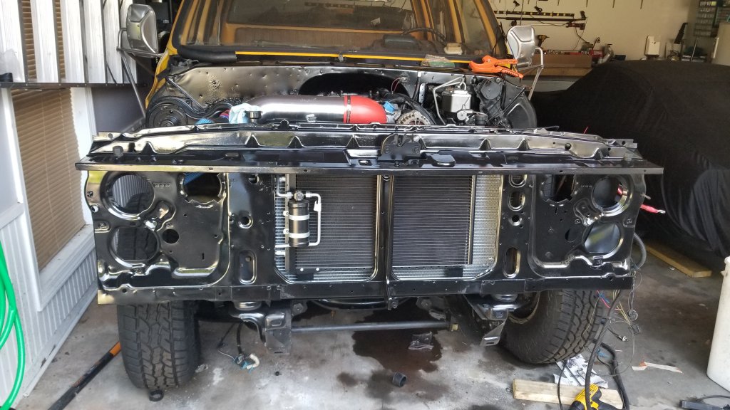

Truck has no factory air. Went with vintage air. Have the condenser mounted up. Bought a high mount Sanden 508 kit from Amos P Garcia on youtube so I didnt have to cut the frame

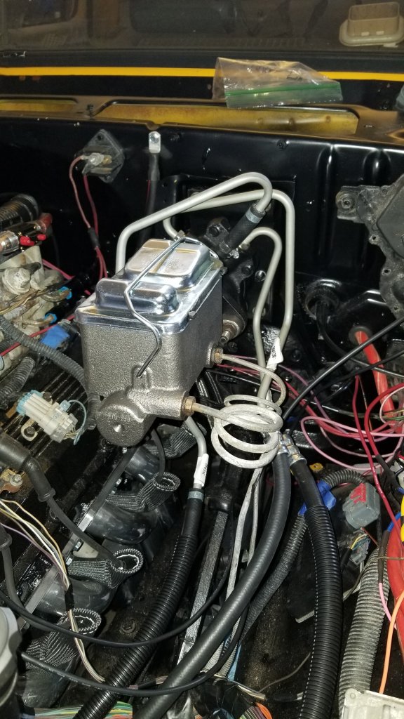

Converted to hydroboost while I was at it. All oem square body lines run where they should. Pressure line screws into the back of the 8.1 PS pump

Fan shroud is from a 6.2 diesel square body. Radiator is a 34" wide core from a 1997 454 square body. Had to modify the upper radiator mounts to make it work.

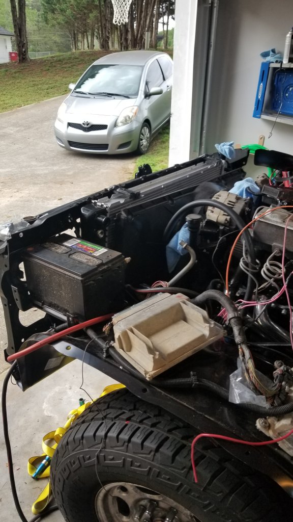

Pcm and TCM not mounted, just resting on the fender for now
