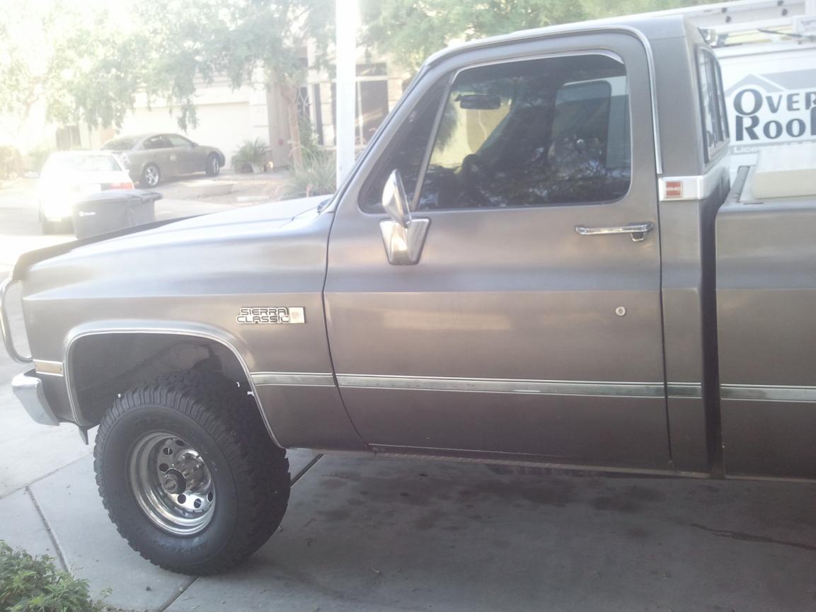

Hey guys brand new to GMSB, actually I'm brand new to the GM world. I've always dreamed of owning one and recently saved up enough to purchase an 84' GMC k1500. I'm in love and the thoughts on what all to do with it is driving me nuts! I want to make it as reliable and capable offroad while still being able to keep it as a daily driver. Any suggestions?
Here's what I know so far......
Rebuilt 350 around 20,000 ago
TH350 Transmission
NP208 Transfer Case
32'' Tires
3:08 gears
10 bolt rear end
First thing I'm thinking of doing is Swapping the gears or maybe the axle as a whole and go with 3:73 gears or a 12 bolt with disc brakes? Think that is a good place to start? Any help greatly appreciated! Thanks.

I'll have to get the photos up tomorrow. I would like to lift it and throw new rubber on down the road but these tires still have a ton of life in them so I'd like to hold off on that. TIRES ARE JUST SO EXPENSIVE! By the way I have scrapped the daily driver idea. I'm just going to keep it as a project/offroad/ camping/back-up vehicle. But I would still like to keep it as practical as possible. No 52" Boggers for me. Just something that looks good and is very well rounded off road. I'm thinking a 4"-6" suspension lift is what I'd like to do, and somewhere around 34"-37" Tires.

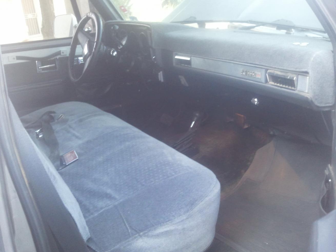

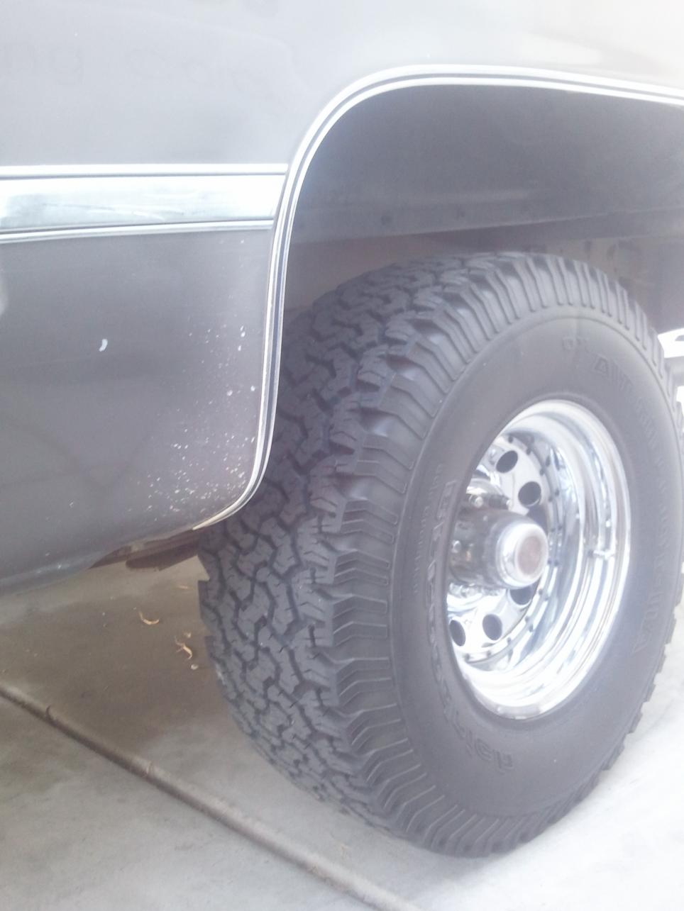

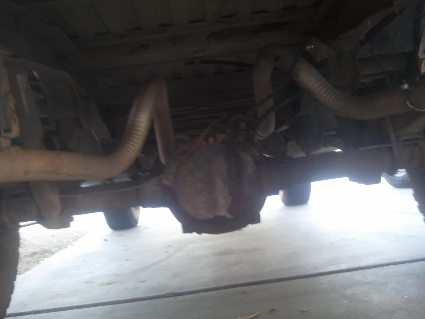

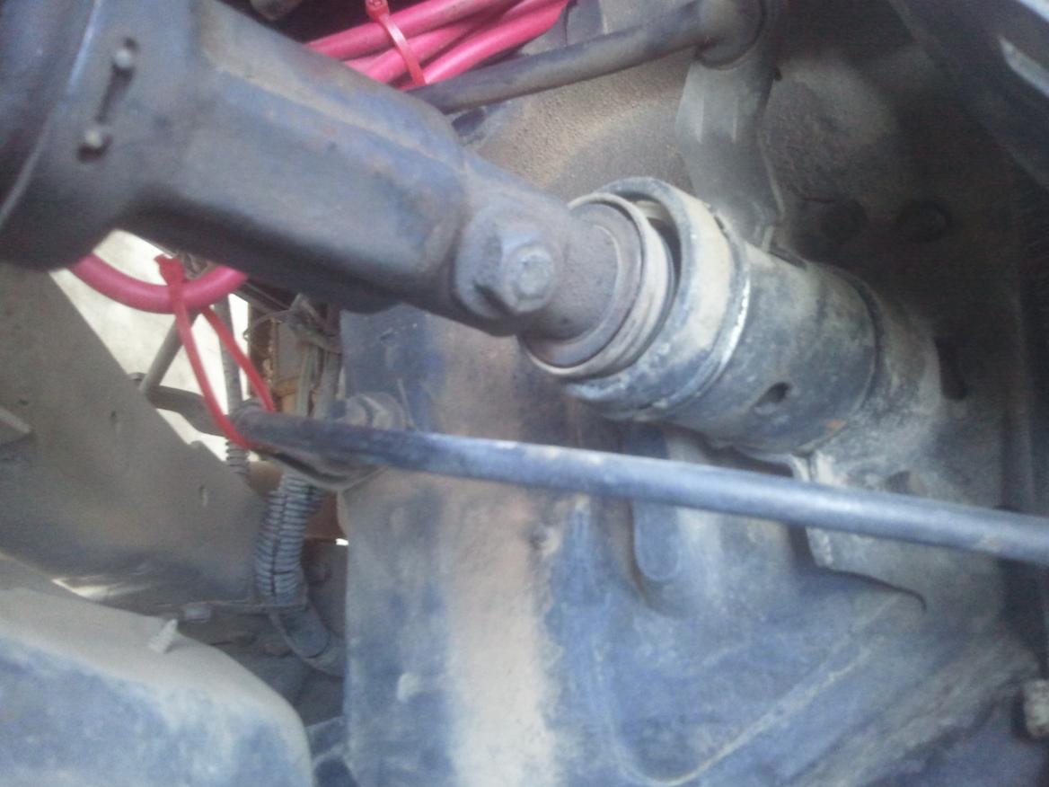

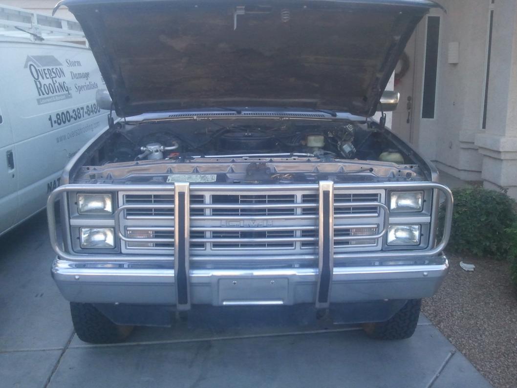

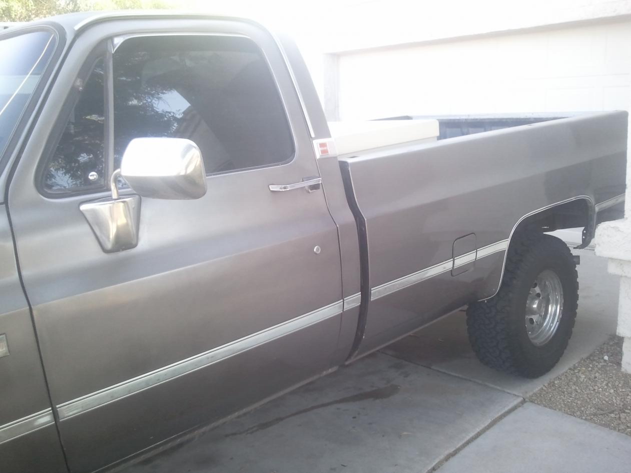

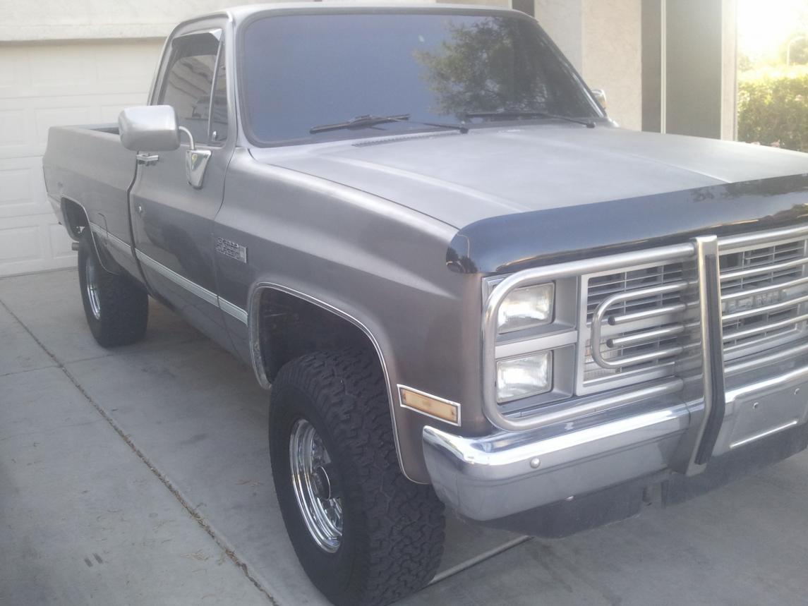

Is there a better way to upload photos than as an attachment?
P.S- sorry the photo quality isn't that good, Arizona is just so bright it's hard to get good photos in the daytime

Rohrs84GMC
May 17, 2012
79
24
Pacific Palisades, CA
k1500
Here's a few more.

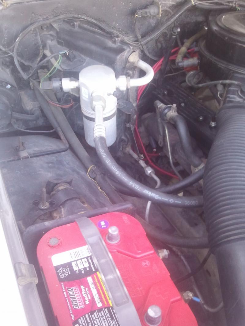

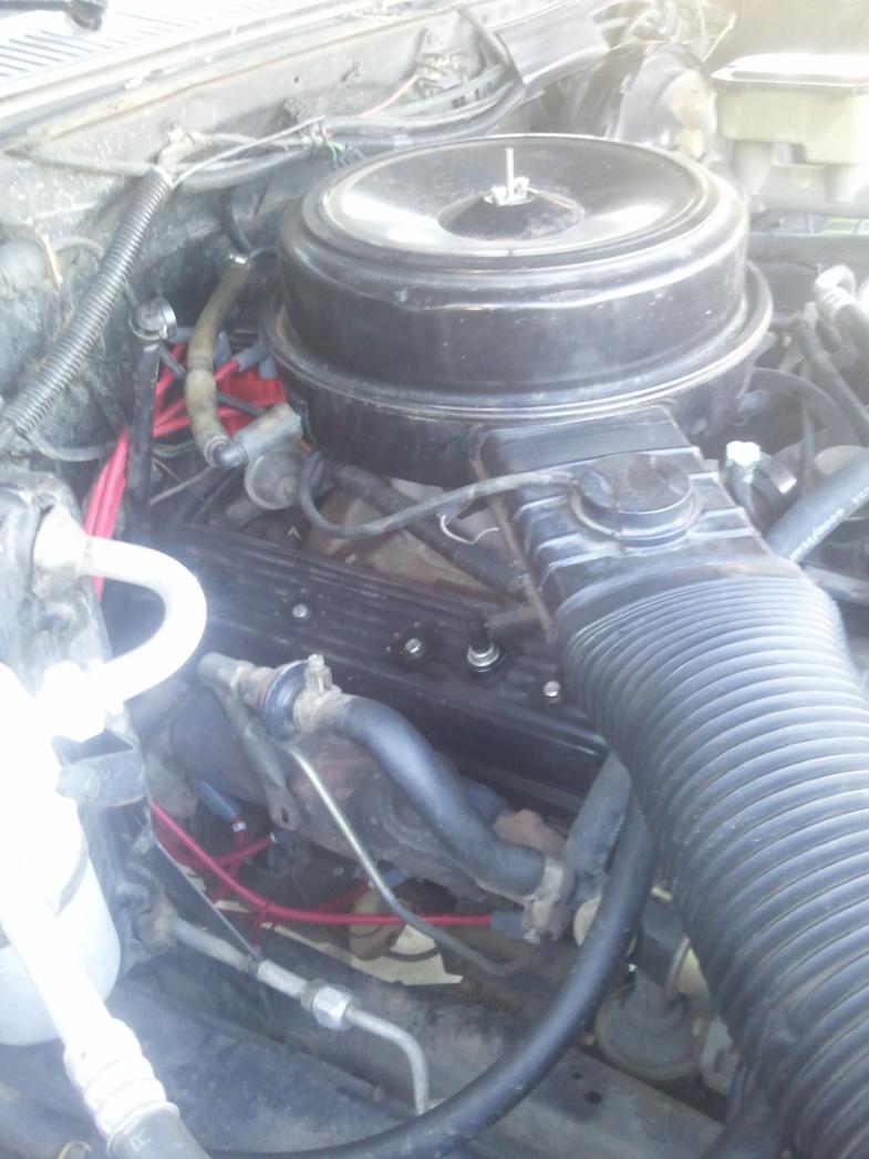

Rohrs84GMC
May 17, 2012
79
24
k1500
Mine as well Continue!

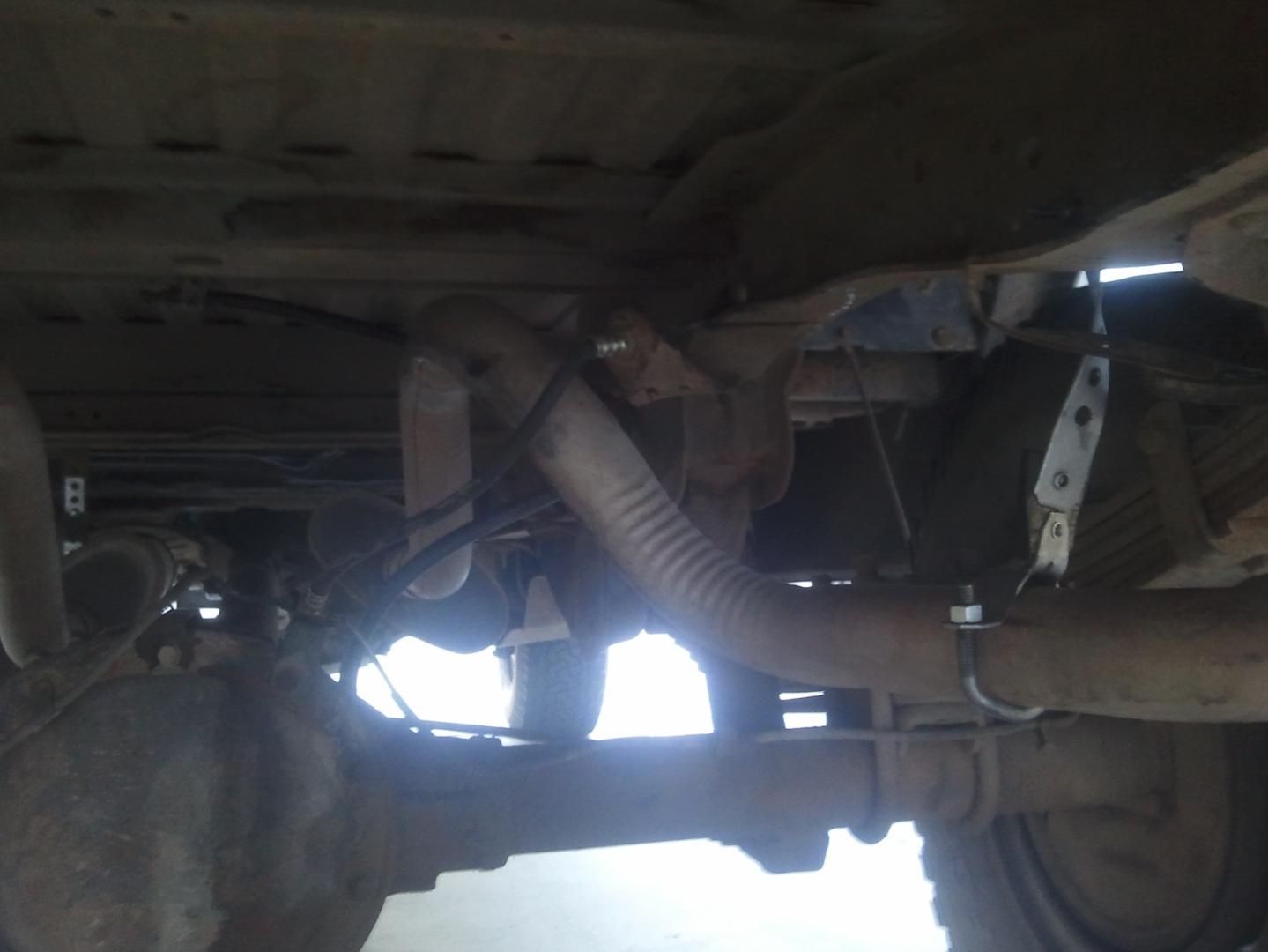

Rohrs84GMC
May 17, 2012
79
24
k1500
Just want to be thorough. :)

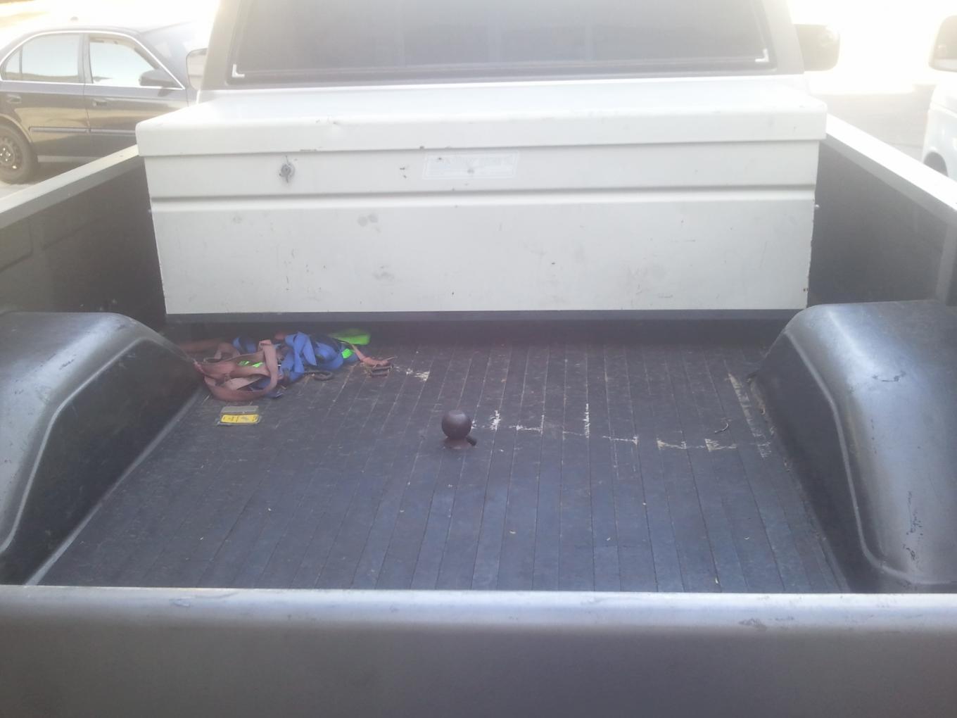

Rohrs84GMC
May 17, 2012
79
24
k1500
Finally Last One! Hope at least one of these helps.

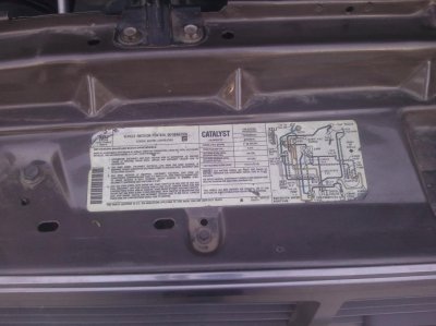

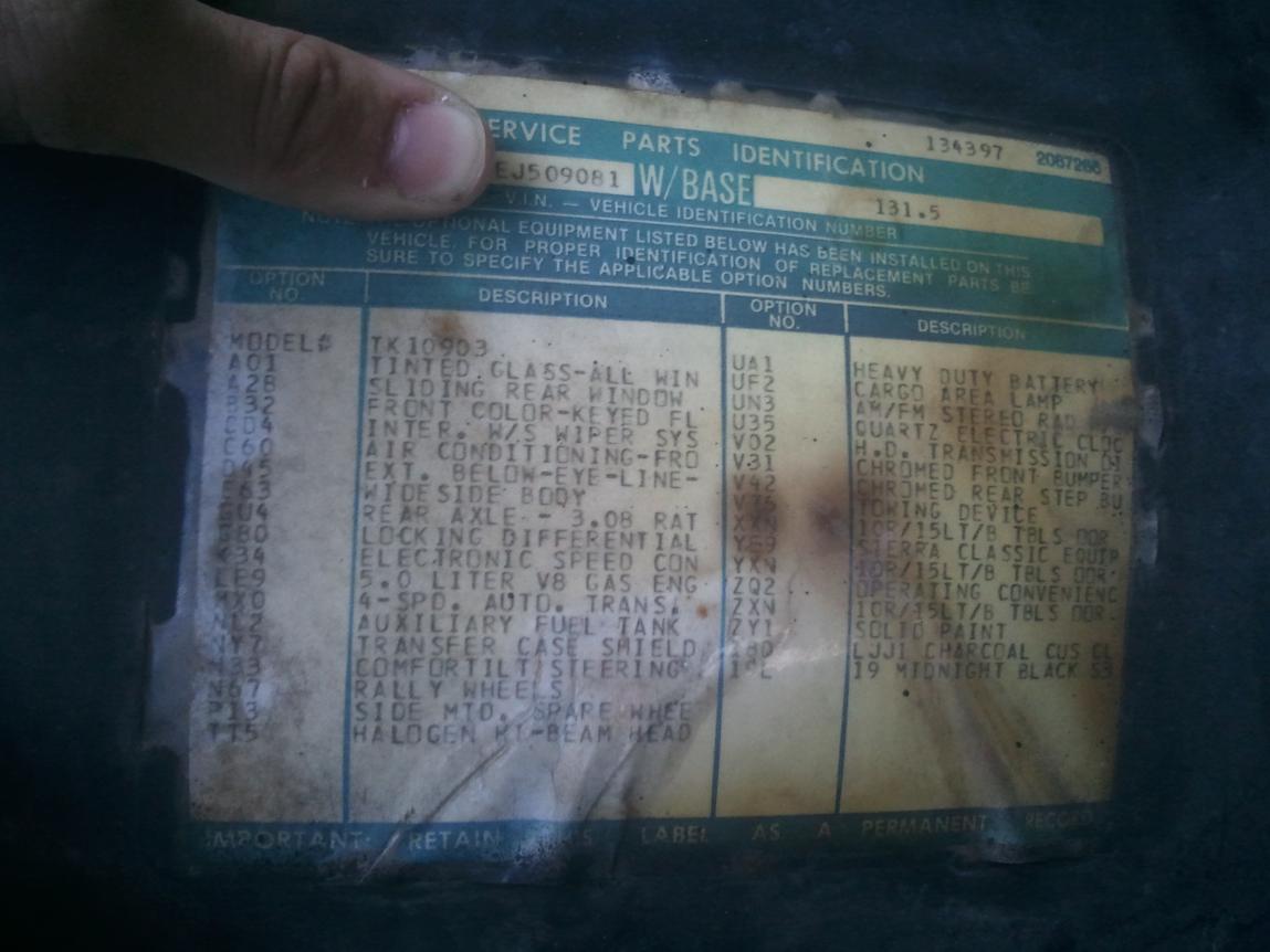

Your the Man! Thanks for the advice. I like the sound of 4.56 with 35" tires :) Especially since it's going to be more of a weekend thing than a DD. this might be a dumb question to you guys but... here it goes. The photo I posted of the factory sticker parts description on the wheel well, It says It came with a locking differential. Does that mean the rear has a locking Differential off the line?
