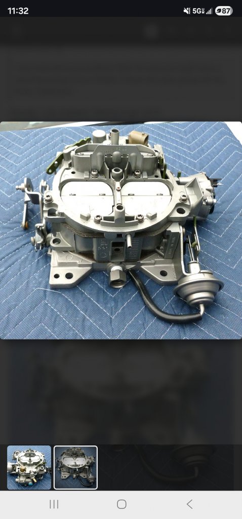

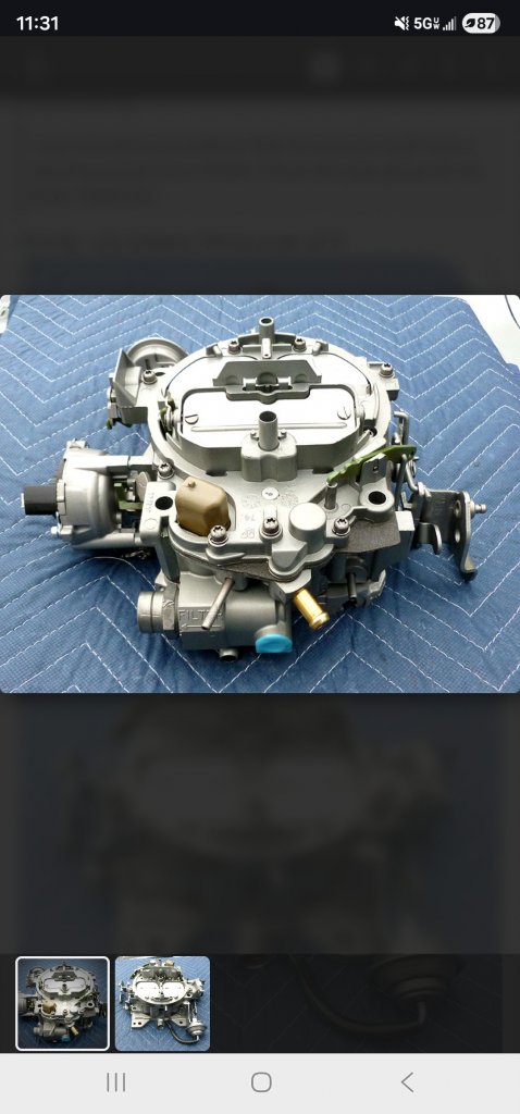

Put an MSD streetfire street fire distributor on your list. Read the directions that come with it about setting up the curve and the vacuum advance.
Here are the pictures of what I was sent.

You can also just use a GM stock distributor, anything for a Chevy with a vacuum advance. The CCC distributor controls the timing by computer, which is why you need to replace the distributor.
10,175
19,677
There are about 100 combinations of stock GM HEIs so yes you could pick one and get lucky or pick one and get lots of pinging and have to retard the timing to the point you lose power and gas milage. The MSD streetfire seems to work good with minimal work and comes with everything you need to tailor it. SirRobynO and I both fought random factory HEIs,no power when tuned to not detonate,others have had good luck,so random HEI is a crap shoot.
