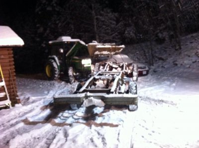

I got to give you credit for doing that out in the snow like that. Determination. :)
yep i'm pretty determined I want to try have it done by the time summer 2015 rolls around or even earlier than that. It's going to be alot of work but ive been out working on it every night now so we'll see how far it gets me. As for the snow, Im one of those people who love snow haha :)

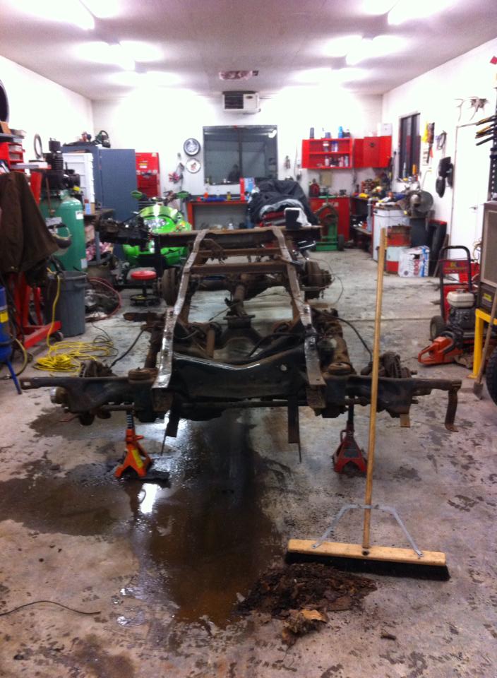

Ended up with the top and sides of the C channel sanded. Got the frame up on stands with the wheels off as well.
That pile of dirt by the broom? That's not dirt. Its rust that fell off the frame while beating on it with the chipper

Nothing like cozied up into the shop and having a tinkering project for the winter! :grd:
47,210
9,487
Lots of work there just to get that frame prepped. Seriously buddy, before I applied anything at all to that frame like a bed liner product or chassis paint, I think I'd certainly hit it first with a coat of Rust Converter. Something like POR15. I hear the stuff goes a long way. You might be able to get the frame done with a quart. Maybe 2 quarts to get everything like the springs and axles.

Thanks for the info Hot Rod, I'll look into that. Where do you normally buy something like that? I'll search for it later, i'm out hunting right now. Yea 89Suburban you can't beat working on a project :)
47,210
9,487
Yep, do a search for their site and they will have a list of retailers in your area you can buy it, and some mail order are cheaper too. I think Amazon even has it. It's quite pricey but worth it. If you don't want to go with that, at least go with Jasco Prep and Primer first. You can get that at Lowes or Home Depot for about $7 a quart, but I don't think it's an actual rust converter. The POR15 converts the rust into a hard surface ready for paint and kills the rust from growing.
I would almost want to sand blast that frame or at the very least use a couple quarts of rust mort and then marine clean and then POR 15
Don't just paint POR15 over that rusty frame. That rust needs to be gone or converted first.
I think you can get a litre of Rust mort for $12 and a Quart of POR 15 for about $50
1 quart of POR 15 will coat your entire frame and a little left for some tank brackets and tow hooks. But I would coat that twice if it were me.
Actually it doesn't convert the rust it simply seals it from the air/moisture thus preventing further rusting. And it can only be painted over with self etching primer or POR 15s special self etching epoxy primer. If you try painting over POR 15 with any other paint it will just fall off with absolutely Zero adhesion.
POR 15 recommends using a rust converter first. Then using there marine clean and then metal prep.
http://www.por15.com/Rust-Preventive-Coating_c_11.html
