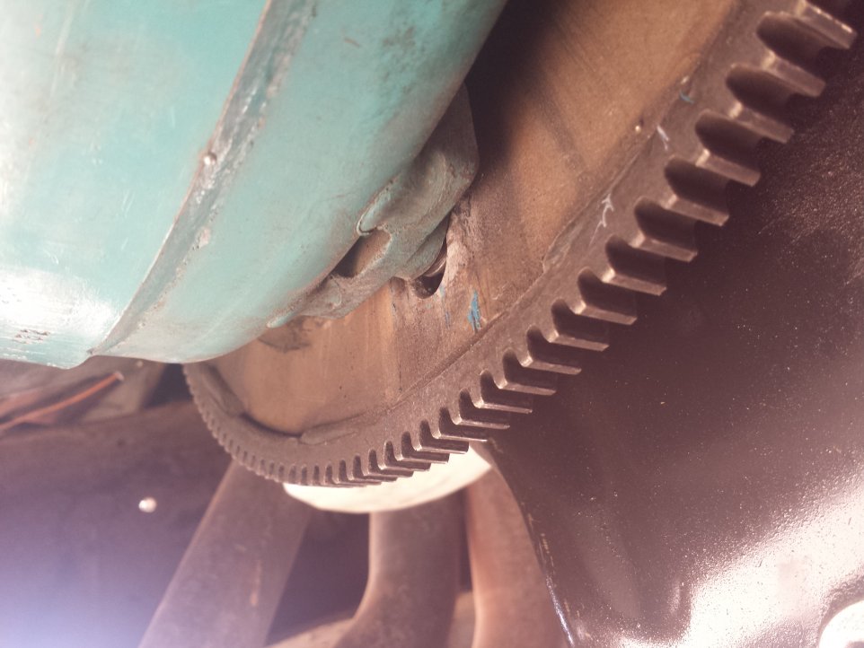

- TC adapting: Most of you would buy a flexplate adaptor. I, on the other hand, decided to go the cheap route and shaved the existing holes on the flywheel with a dremmel, since the the holes did not line up correctly to fit the bolts thru. Worked like a charm!:smoke2:
And yes that's a 4l60e converter.

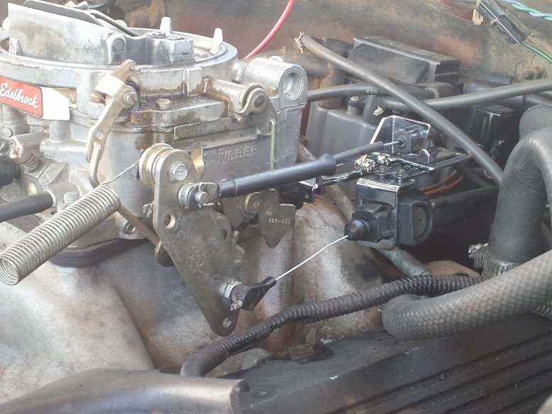

- TV cable stud for Edlebrock 1405/1406 ($7)
- Bracket I bought on Amazon ($7).

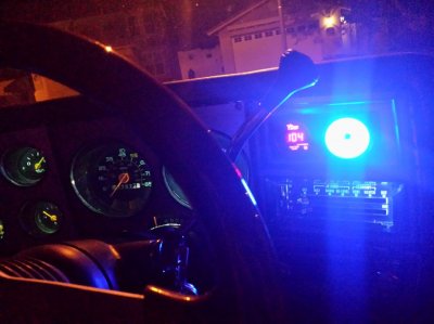

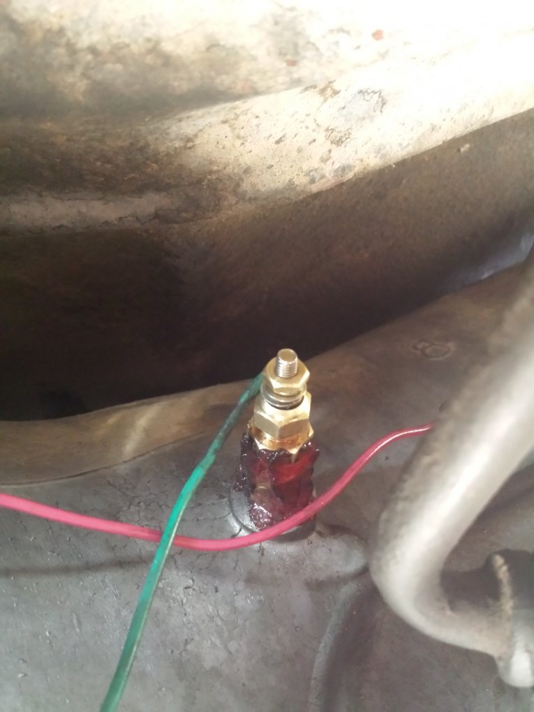

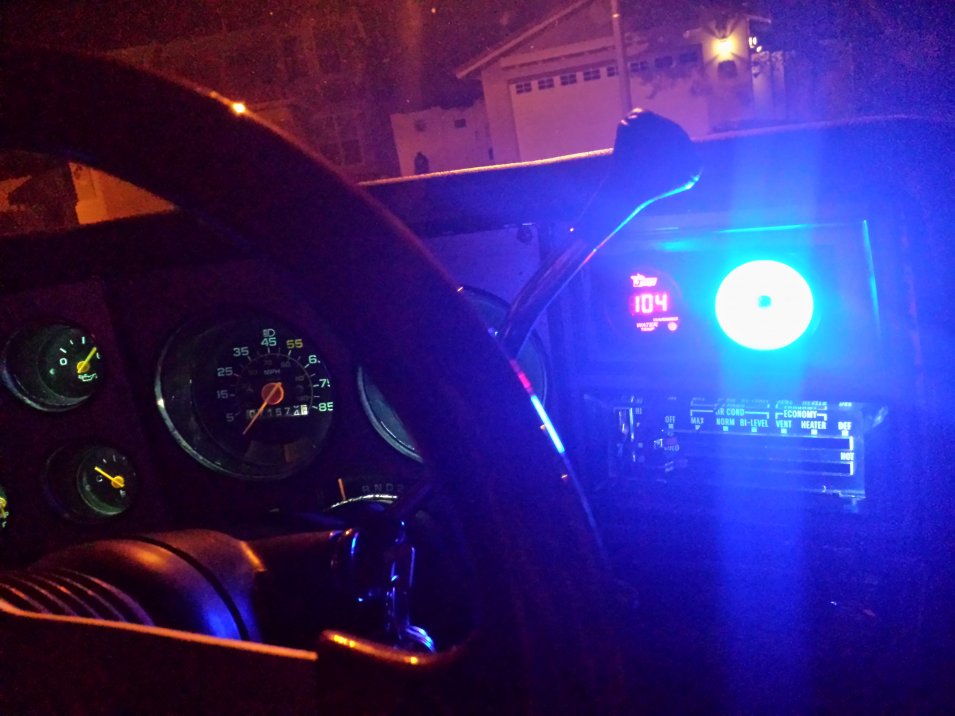

Temp sensor is at the pressure port on driver side. Added Goop to prevent leaking fluid. Trans runs average 190-203F. I have factory oil cooler mounted behind the grill. Thinking about going bigger tho. Haven't decided yet.

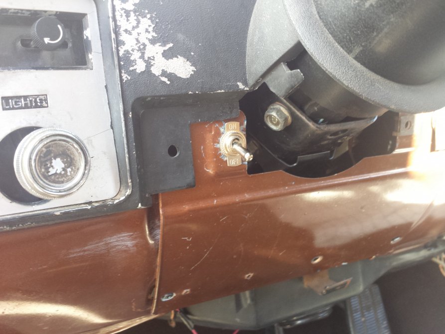

Ground is wired for 4th-only TC lockup and have mounted 12v toggle switch with fuse.
