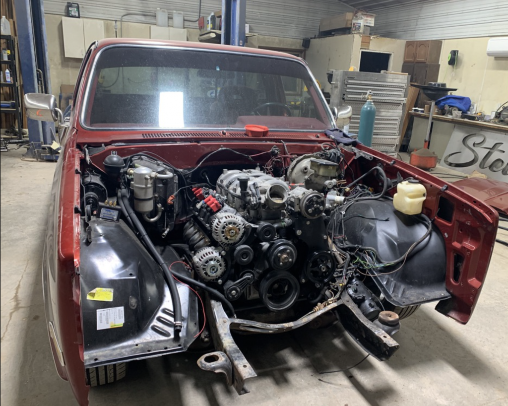

After seeing this again. Sometimes that AC pump is down in the frame rail. You may need to relocate or some have boxed the frame out.

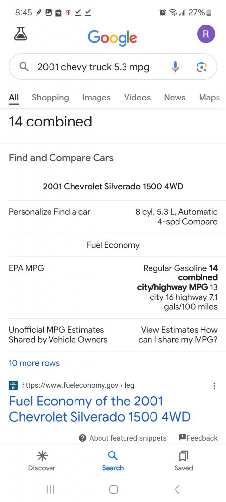

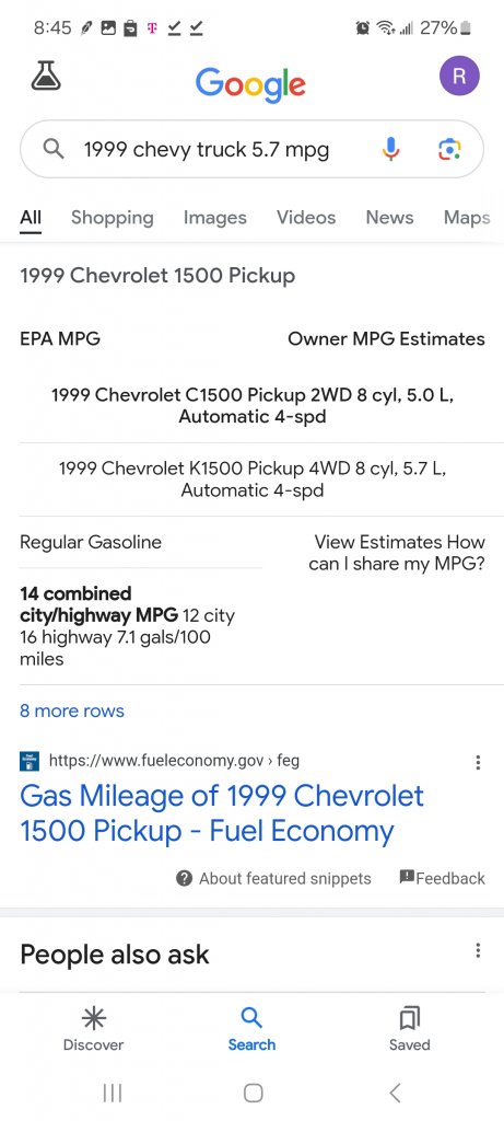

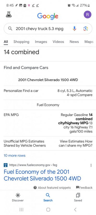

I'd take the other side of that bet. The 5.3s get good milage from the modern engine management. Compare a factory 5.3 pickup and a factory 5.7 vortec pickup not a big difference mpg wise because they both have way better engine management than a carbureator and mechanical distributor.
