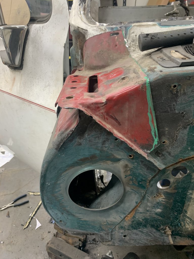

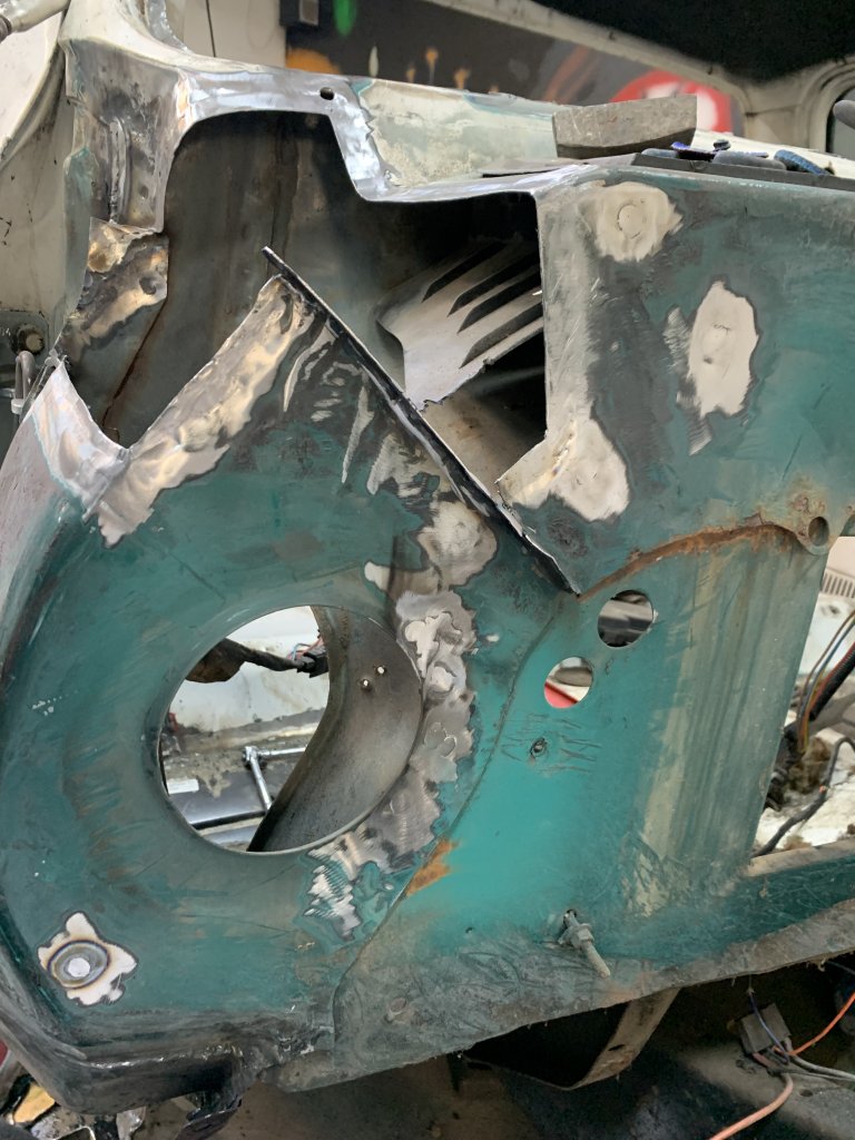

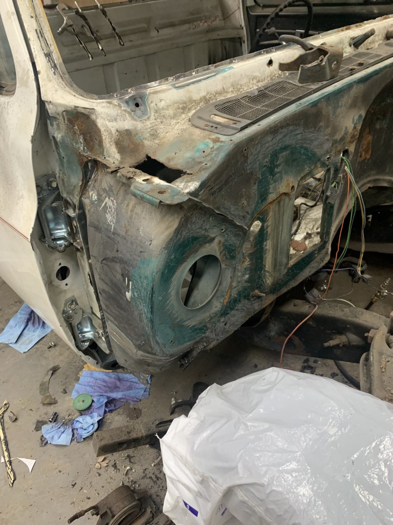

It’s a lot less work then going the other way, everything will transfer over, if you go 86 and put a 79 cab on you have to make modifications to the upper front cab corners like my nightmare lol, originally my dad just cut the rectangular holes to accommodate the newer style hood hinges, but you won’t have to do that.. slight alterations to alignment and mounting holes but nothing major bubba
