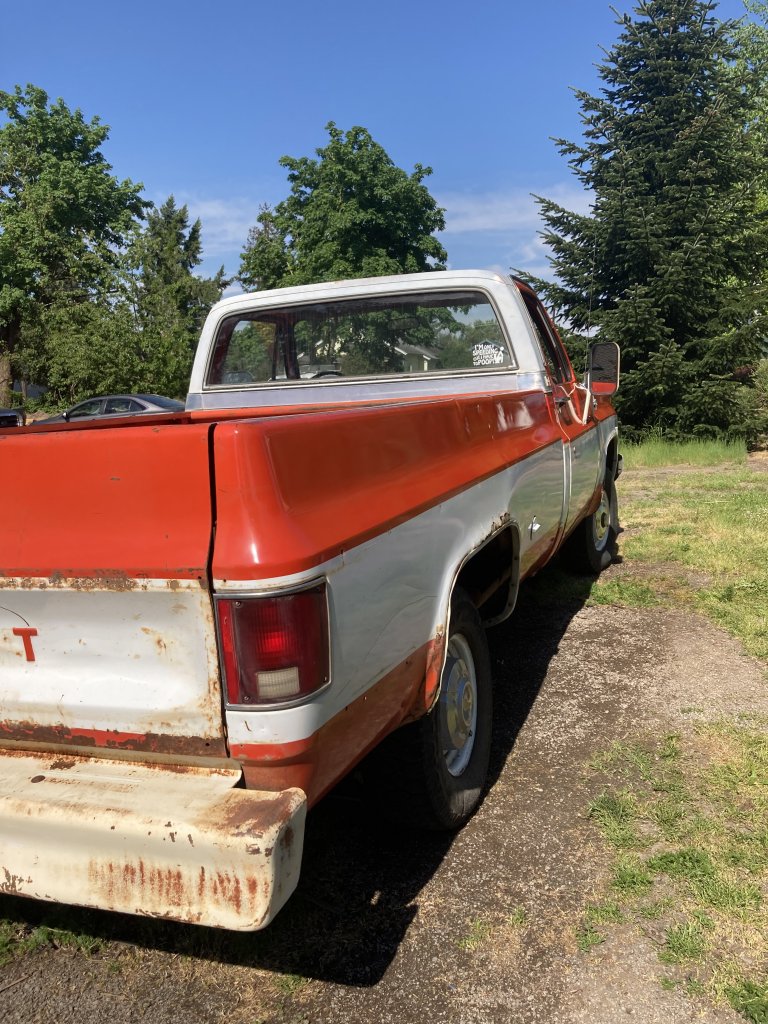

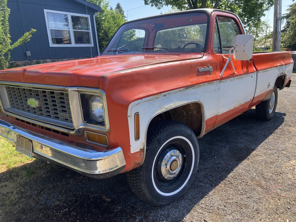

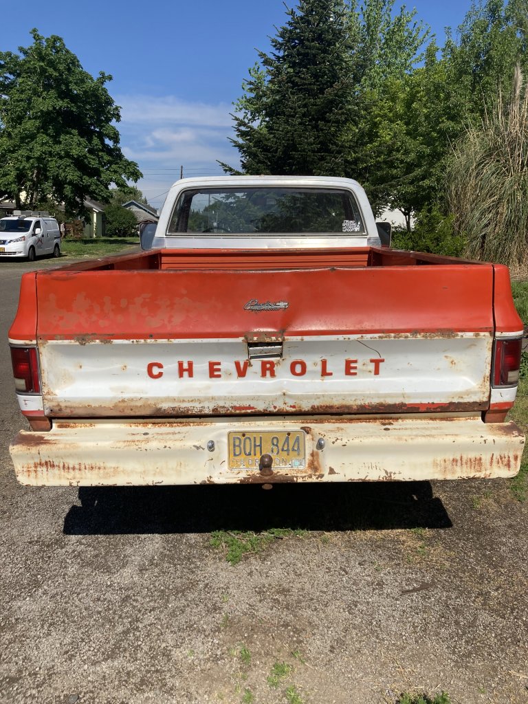

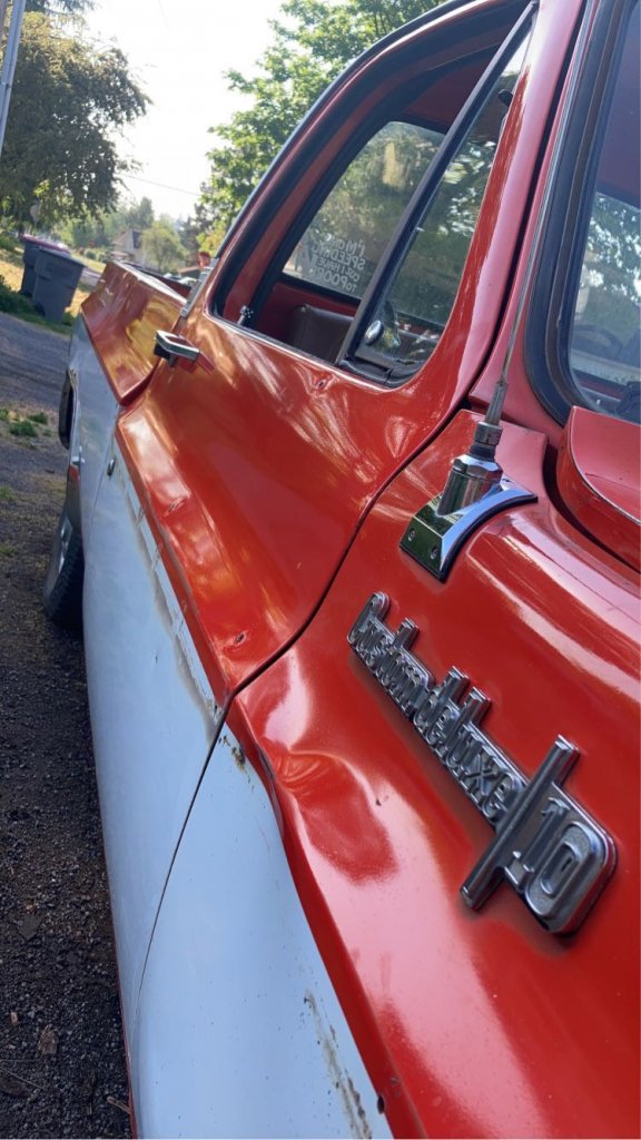

my 74 full time 4x4 k10s bed is unlevel, on the passenger side it is higher than the trim and body lines ect. The left side looks normal, what could be causing this? It’s not the frame I know that much. Here’s some pictures.

So it’s like this when sitting on level pavement?, It may not be the bed But worn body mounts/Cab mounts ? IDK just a thought.
Park it on perfectly level pavement, Take some measurements.
Ground to wheel Arch, Ground to Frame, Check for level on front of Bed and top of tailgate.

My guess would be a rotted out cab mount on the passenger side of your cab.
Usually the lowest "thing" is where the problem is. Gravity is a powerful force. Things usually don't become unlevel by defying gravity.

I would start by checking your rear cab bushings and the cab mounts they sit on first. It's not uncommon for the bed on these to not be dead square all the way around but there's a big difference in heights there. And 4x4s use a taller cab bushing so the effect is worse when they start to fail.

Tires the same size? Sacked out suspension will cause this as well as body mounts. A twisted frame is pretty much the only other option. Also parked on not flat ground will only enhance the problem.
