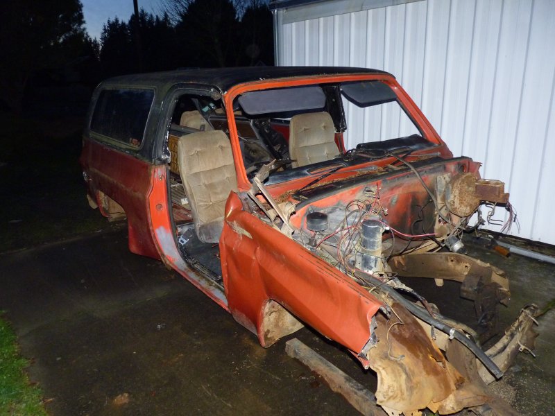

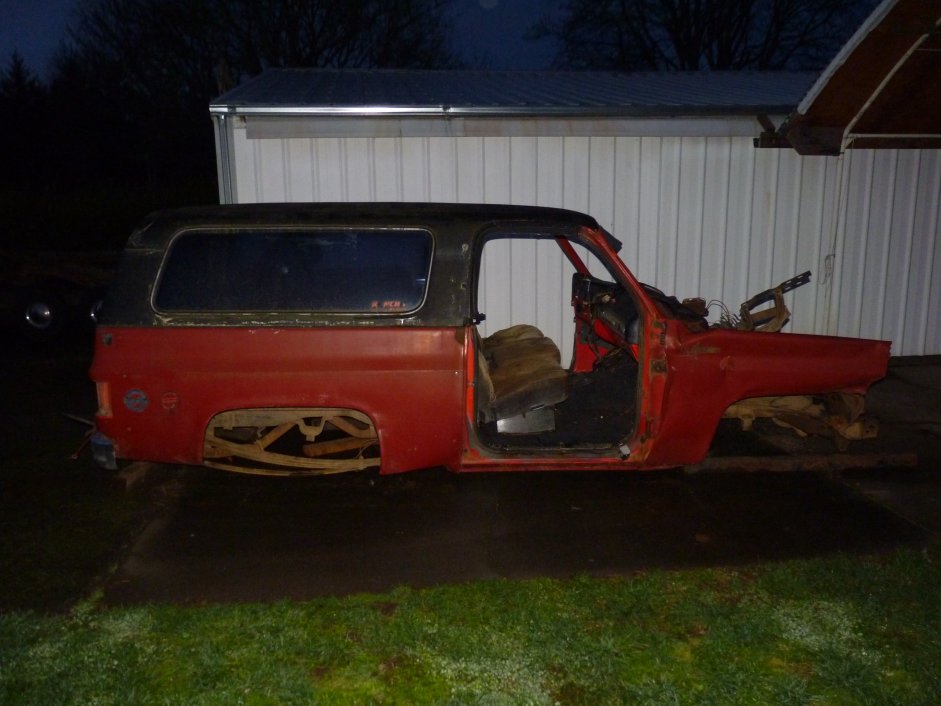

Yeah I'm waiting on the new hooker ls swap kit stuff to come out for our trucks. I also need to collect some front end parts for the blazer. This is the body I finally got for it.

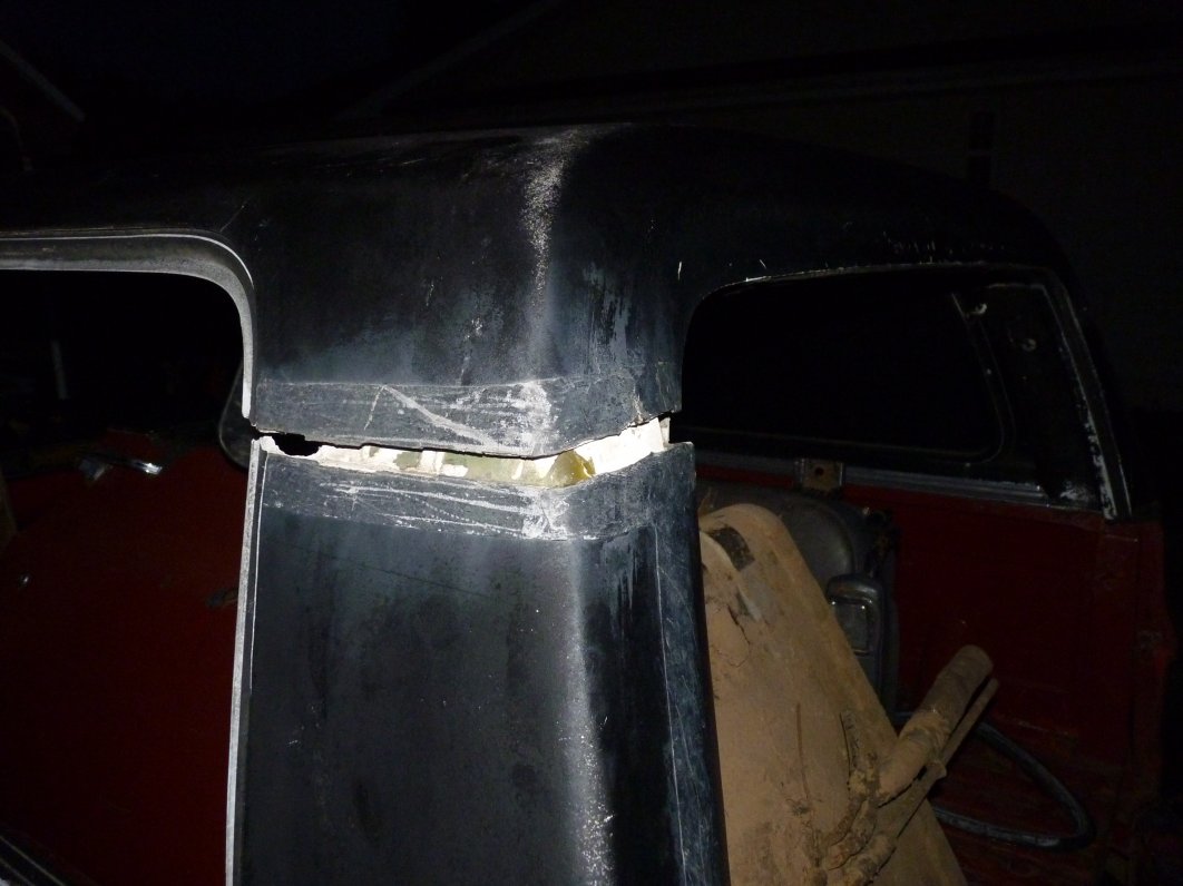

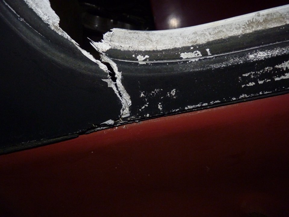

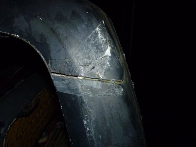

the top needs work badly, trying to decide if I just replace it and if I do replace it do I go white or black.

Yea it looks to like it needs to be replaced. Still it's a blazer and you could take the top off and ride :)
