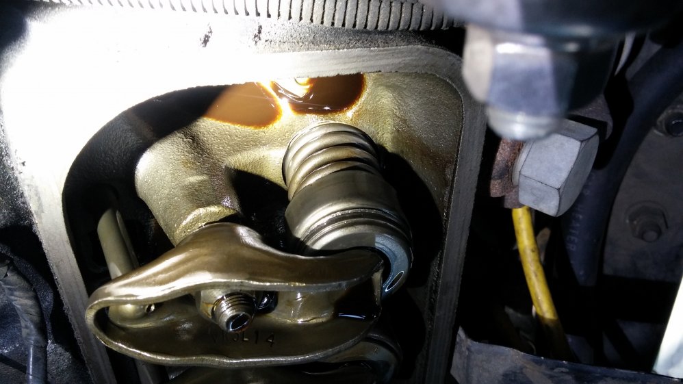

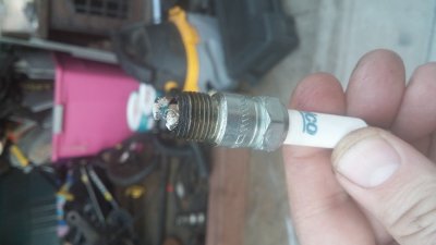

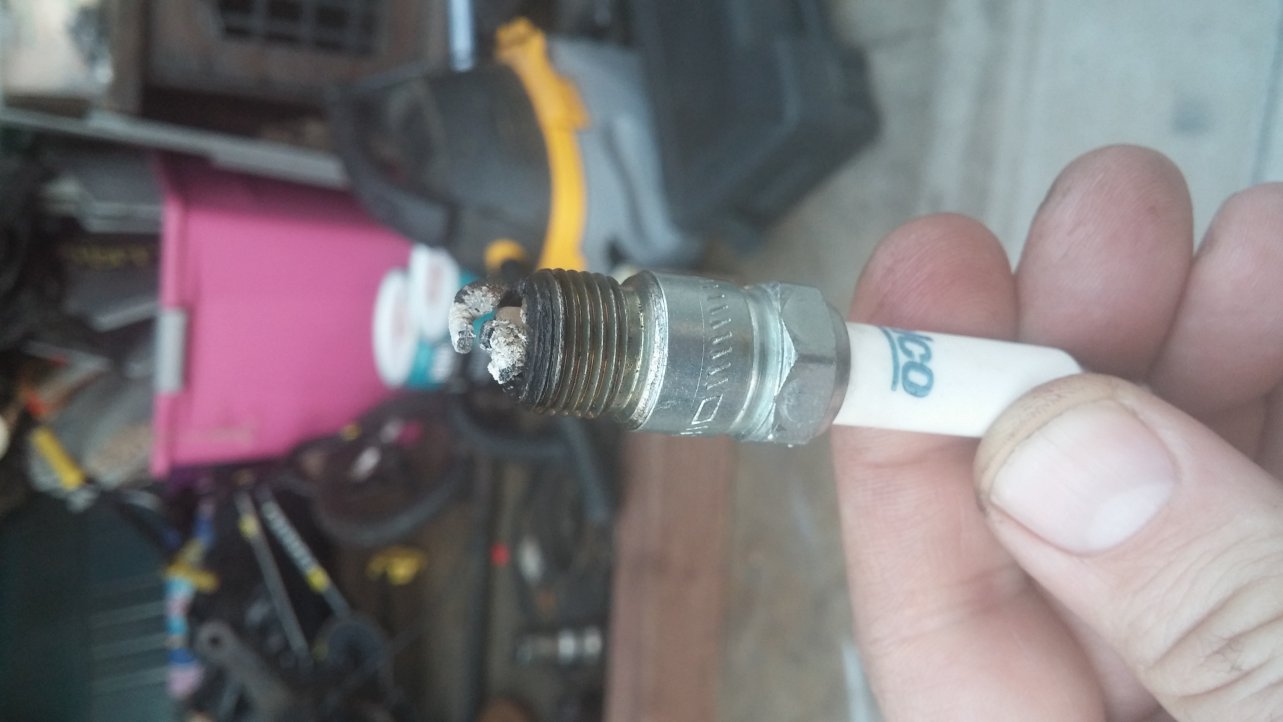

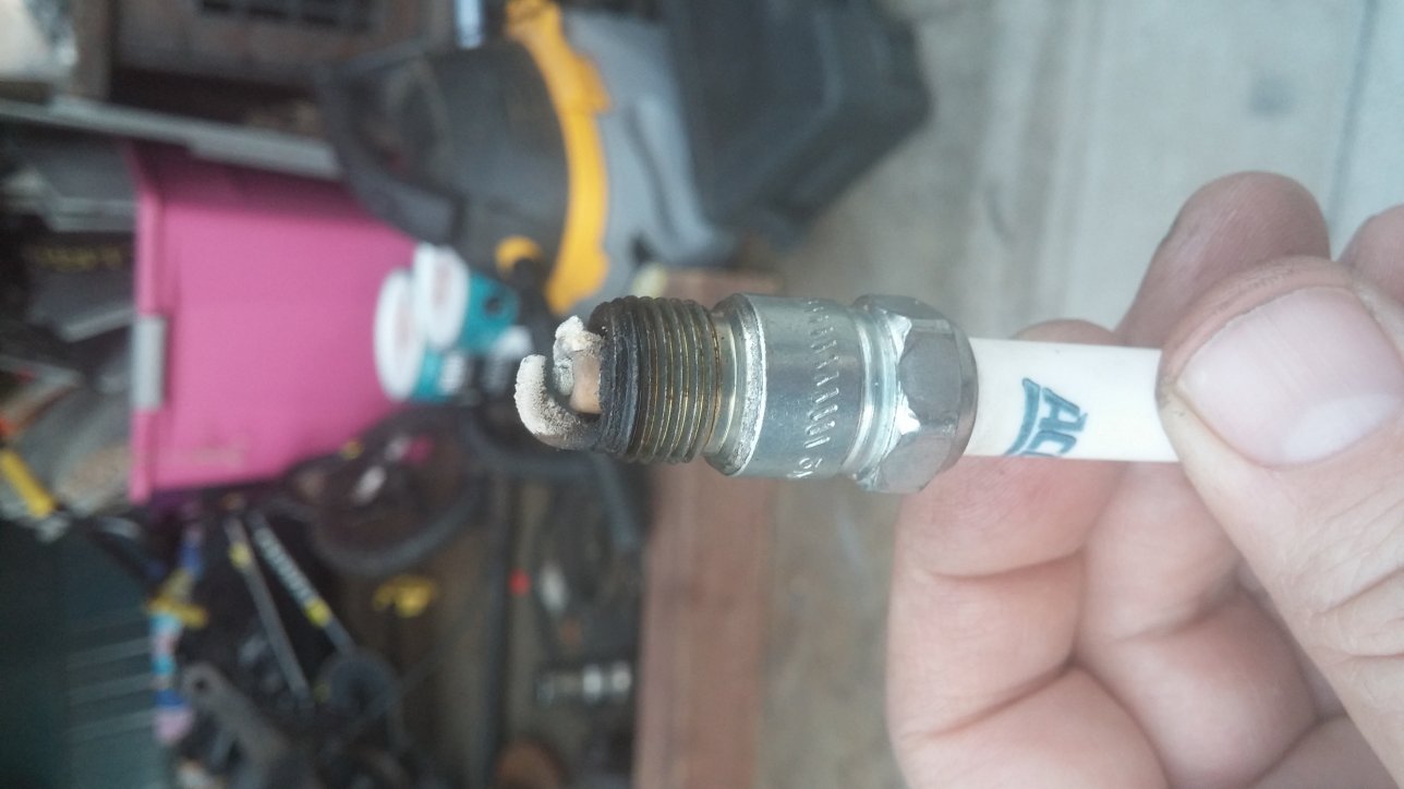

My truck started running really bad so I pulled the plugs. The first cylinder on the left hand side spark plug was totally fouled, caked over with something it didn't look like oil because it was dry but was told its oil fouled. And its only the one plug that looks that bad. I did install new plugs and it does run ok with new plugs but the spark plug dosent look good out of that cylinder.

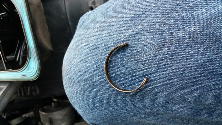

So I pulled the valve cover just to look inside and I found a broken metal ring down around the bottom of the valve springs where the oil puddles. It looks like it came off the top of the exhaust valve spring, first one towards the front of the motor. Its the same cylinder that is fouling the plug. Should I pull that one valve spring and replace it along with the seal or should I just go ahead and pull the whole head and take it to a machine shop???

Does anyone know if that ring on the top of the exhaust valve spring is a critical part?? Im about to pull the cylinder head off this thing,,,,don't want to because I don't know how to set the valve lash when I put it back together,,,

Are you having any backfiring problems? Some kind of valve train failure happened there. It is part of the spring cover or part of the spring dampner inside the spring? Makes me wonder whatever went wrong, did it destroy the valve seal and or valve guide and you're getting alot of oil on that plug and it's getting baked on the plug.
Do you over rev it by any chance and ever float the valves?

NO, you didn't over rev it then. Stock OEM valve springs will handle 5,000 rpm easy. I was just wondering if you might have floated the valves a time or two. And the backfire doesn't seem to be consistent enough for permanent damage. So the valve face and valve seat should be undamaged at this point the way it sounds. You just have an issue with that one valve and it's components. I'd probably fill that cylinder with some small rope and bring the piston up to TDC so that the valve can't fall down in the cylinder, then remove that valve spring assembly for inspection and go from there. The valve guide might be worn, but for a patch job, replace the valve seal with one of the better umbrella type seals while you have it apart and that will work as a band aid for quite some time.
