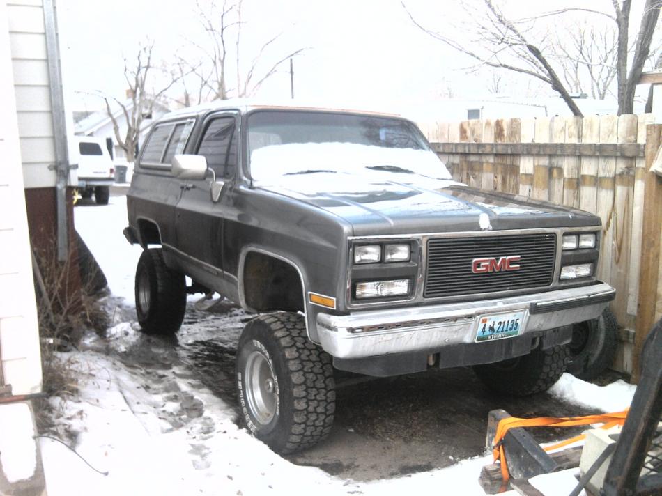

I know exactly how you feel I have a 90 gmc jimmy that I have rebuilt from a bare frame.
all that is left is minor body work and paint. it has a 6'' lift and 33'' tires
I do not want to even take it on a dirt road cause all the work I have into it I has less than 1,000 miles since its rebuild
I am going to convert it to 2 wheel drive and lower it
my plan is a nice fuel injected overdrive tranny cruiser I will get more use out of it as a low rider
now you guys can cuss me all you want

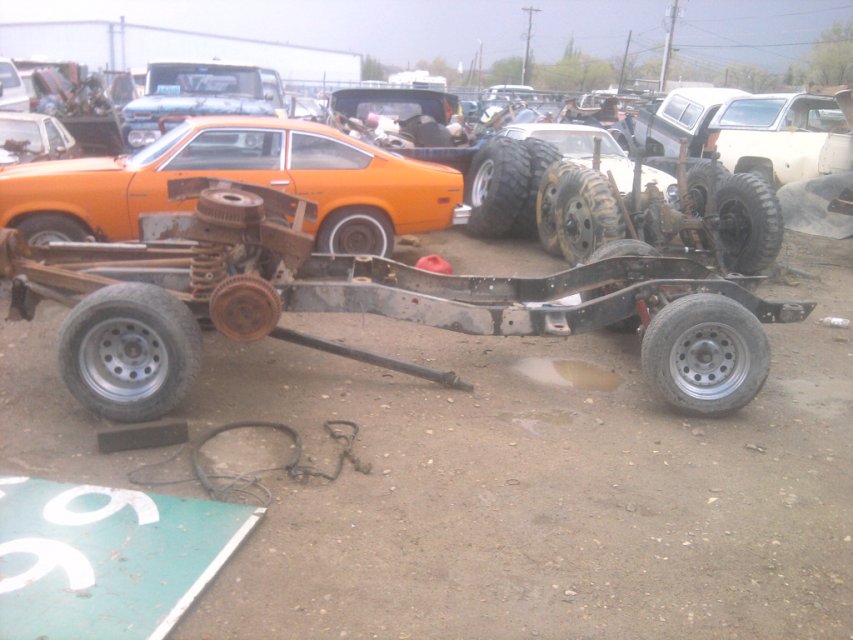

my plan is to use the front suspension from a 2 wheel drive truck
lots of measuring and lots of holes to drill

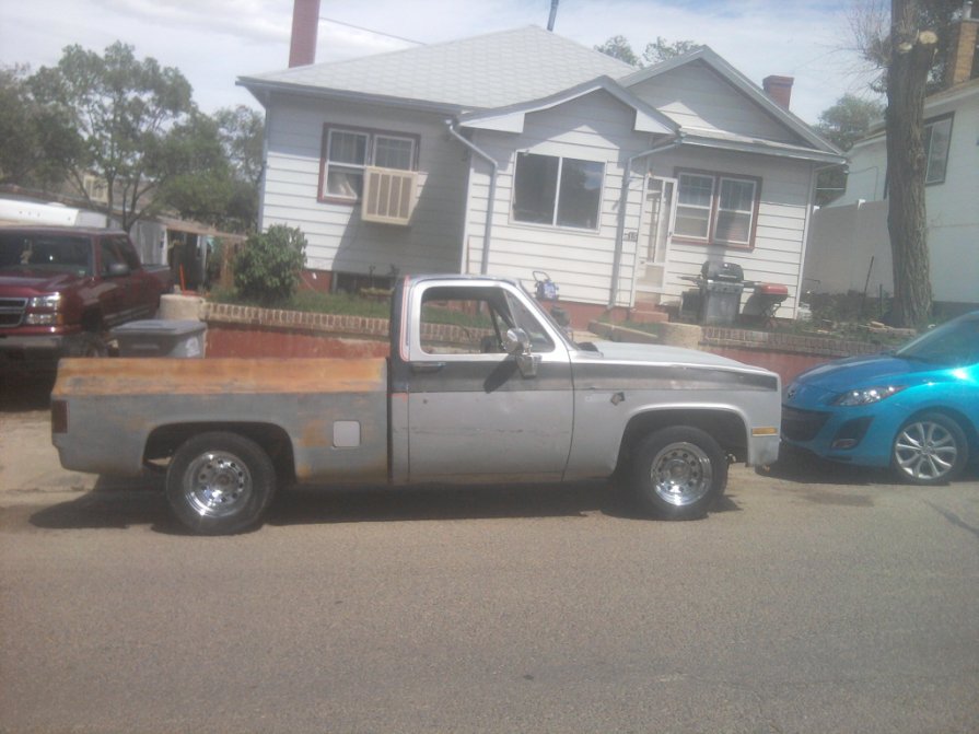

I want to convert my jimmy to a 2 wheel drive for a smoother ride and to lower it.
I just put a new mad dog transmissions stage 2 700 r4 in my jimmy so I am thinking about clocking the t case up so it does not hang down after the
conversion or swapping in a 2 wheel drive tail shaft
my 85 low rider use to be a 3/4 ton long bed I parted it out for the cab and front clip to build the low rider
