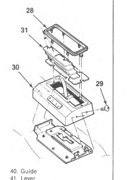

I was fixing small things on my k10. 4wd shift lever light has never worked. I removed the 4 screws from the housing, but it won't even wiggle. What am I missing? I've never had to work on the shifter and I'm trying to be careful with 39 year old parts.

the shift lever boot may be keeping the plastic cover in place.
give the boot a little twist and see if that helps.

Just four screws. What transfer case?

N208
I'm referring to the cover.
Thought I would ask before I accidentally used too much force and break something.
Edit: I guess the correct term would be bezel

There is a little slider that goes around the shifter, for the indicator, that'll fight you a little but it should pop right off.

Success... just a lot of gunk from the years I guess. Once I tried a little harder it came right off.
I'm going to have to reconsider the light bulb. It's ever so slightly melted where it goes.
Bad design I guess.
