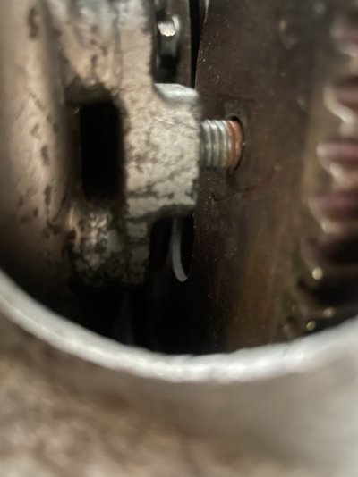

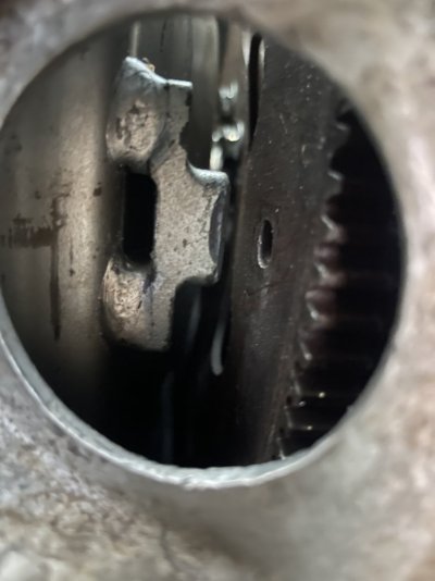

FYI I should have included this in the original post : The TC was not bolted to the Flex plate when I turned the Engine by using the Break-over bar

These are pics of where the TC is now ..The. Lot in the second one is barely threaded in ..Do
You think I need spacers ?

The rule of thumb is 1/8 to 3/16 inch of converter pullout. In other words, with the converter buried in the pump as far as it will go, you should have 1/8-3/16 gap between the mounting tabs and the flexplate. You can usually get away with a little more than 3/16, but ideally you should use some washers to take up some space.
Did you reseat the converter, or actually remove it and inspect the pump? If the converter wasn’t seated and you tighten the bellhousing bolts, most likely the pump rotor is broken. Bad (and expensive!!) things WILL happen if you start it like that.

@Matt69olds..I measured from flywheel to TC Tab and got .136 that night .. ..The next morning I went out and was turning the TC by hand and pushing towards the rear end & it seated my gap is a little wider now it’s spinning in the bell housing by hand ..I can see it’s in the pilot bushing and I hear some clack clack’s when I move the TC back-and-forth no grinding noise ..I have another transmission on stand by
