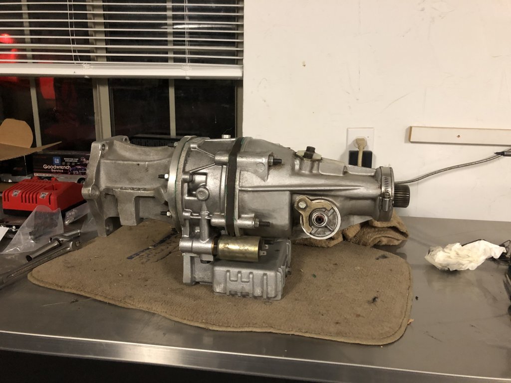

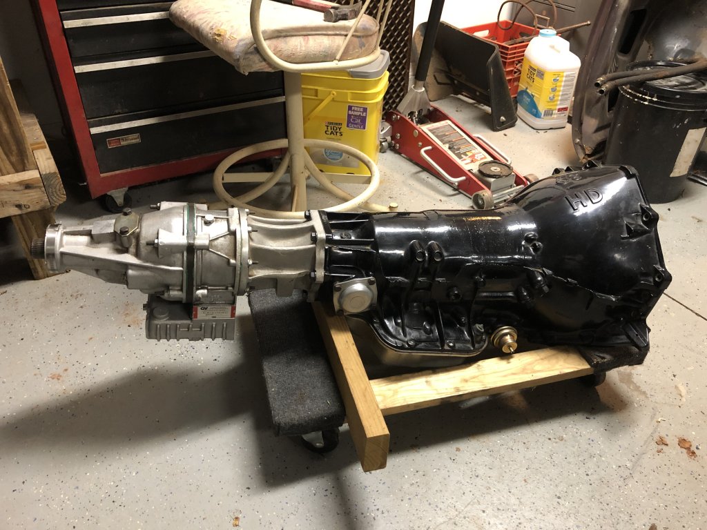

I’m currently running the gear vendors OD set up on my 82 C20, has factory 454 & turbo 400 trans with 4:10 rear gear & 33” tall rear tires. Cruising 70 mph @ 2500rpm no problem, gear vendors basically replaced original tail shaft housing on trans with trans mount in stock location. Changed drive shaft to a custom built one piece unit & cut off carrier bearing mount, no other mods required. Controls for the gear vendors consist of a small under dash switch & floor mounted dimmer switch & a small control box i mounted behind my dash cluster.
