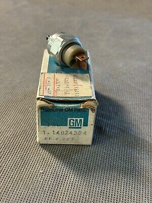

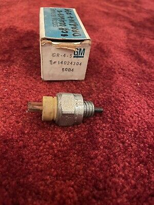

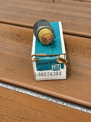

I can tell you I bought mine in 2021 from https://www.ebay.com/usr/abssrsautomotive .
It was P/N 265067046679. That P/N does not come up on Ebay anymore.:(
The OE P/N was 14024304.
Long ago discontinued.
