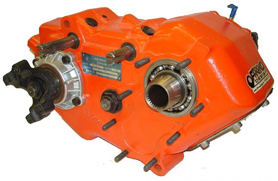

You'll need a TH400-specific NP205. The input shaft of the NP205 is female, which is an oddball compared to other transfer cases.

attachment.php

You may want to look here:
http://offroaddesign.com/catalog/transfercaseparts.htm
"NP205 parts
NP205 input conversion Kit:
Convert your male input NP205 to a TH400 version 32 spline short female input gear. Kit includes new input gear, input bearing and a seal and gasket kit. Requires machine work on the NP205 case to install, the input bearing bore must be enlarged by about 3/8" compared to the small bearing."
incase your search for one doesnt pan out.
