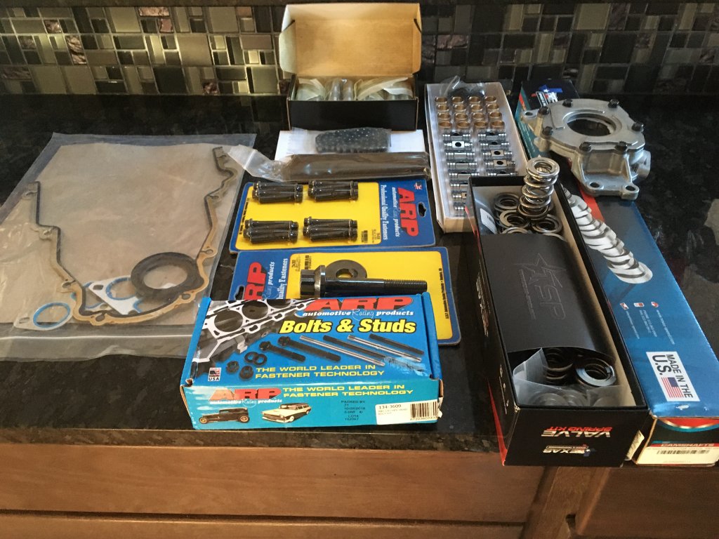

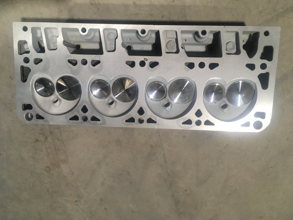

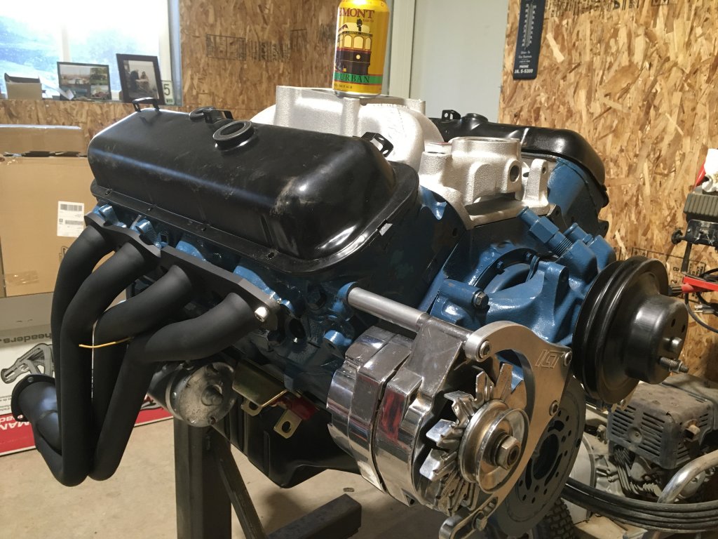

I have both a 6.0 LQ4 and BBC, building one now, and no cheap date for sure. 383 from a gen 1 350 is fairly reasonable, if you have the motor etc. I would look at your budget real hard, as everything adds up fast. Have over $5000 in mine and not done yet....
