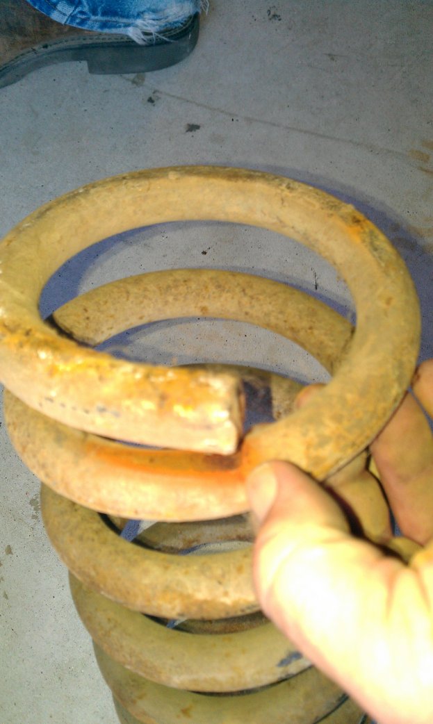

okay yeah thats what i was worried about cutting half was getting it back in the pocket. and thats good to know i can remove the 4th spring in the back too. also, I've never cut coil springs and if i decide to go with a full round, where or how do i measure what a full round is? is there a spot on the bottom of the coil that is flat or is it curled all the way down?

Cut right where my finger nail is with a cutting disc, saws all, or band saw. Do not cut with a torch.
