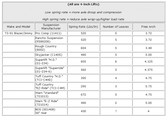

I returned my Rough Country 2in lifted leaf springs.
Ordered Tuff Country 2in EZ-Ride leafs for the front end.
They had the lowest spring rate according to this chart I found over on the K5 forum.
I will report back when installed.
My original (84) leafs have 2in of travel until they hit the bump stops.

The 2in lifted TC ez leafs will likely arrive tomorrow.
I also received a 2in shackle lift as a backup plan:
https://proformfab.com/products/1973-1987-chevy-full-size-2-front-lift-shackle-leveling-kit
If I have time, I will do the (easier cheaper) shackle lift first. Measure the net lift. Try to evaluate the ride quality best I can with the 41yo originals front leafs.
Then swap in the EZ ride leafs and remove the shackle lift. See how that is. If they ride nicely, I will just leave them in place.
