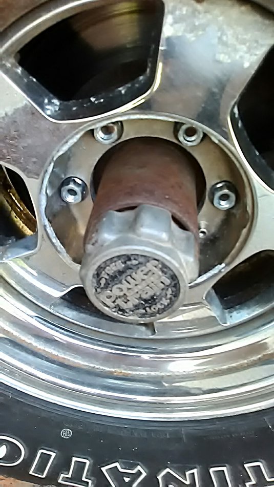

Let's try a different route. From your pictures, it looks like you still have the smooth front hub covers and not part time hubs. I believe you said at times, even though you may be in 4 loc, you don't get the front tires to spin.
Have you ever popped off one of those front covers to make sure the gear that locks the hub to the axle is in there? Just a thought.

@Craig 85 I think it was @bucket that helped me determine my hubs are some sort of "custom hybrid" I Guess? the locking hubs changed bearing sizes from big to small being the whole dealy turned or the little thingy that
turned inside of the bigger deal. LoL.
It is assumed that my truck has the correct 1975 Dana 44 but some genius has mixed the small inner hub piece to the bigger "whole knob" outer piece and maintains the correct bearing size for the axle. What you're looking at says "Power train Products" on it, it's great big as pictured, but a 1975 D44 SHOULD have the smaller bearings/knob/dial thingy (after being changed to a selectable hub ofc.) You're right about the stock configuration...ofc.
Whatever . Hope that answers your question. Thank you. LMAO that makes sense, right?
