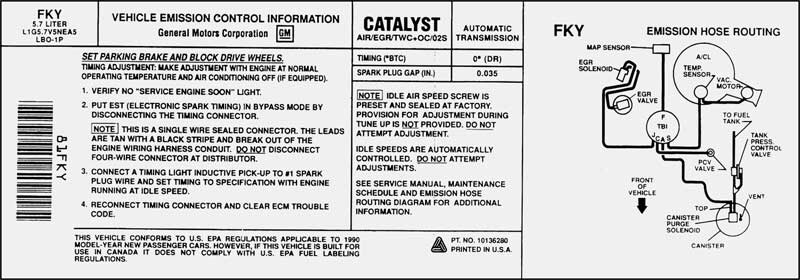

I'm close to what he has, a Cali spec '89, but I don't know for a fact that V1500s and V2500s got the same equipment. Some years the 1/2 tons got air injection while the 3/4 tons didn't. We don't even know if his was a Cali truck or a 49-state vehicle.
And there was also 2 different GVWR's on the 2500's IIRC, and smog equipment is likely different and less if he has a 8600GVWR.
