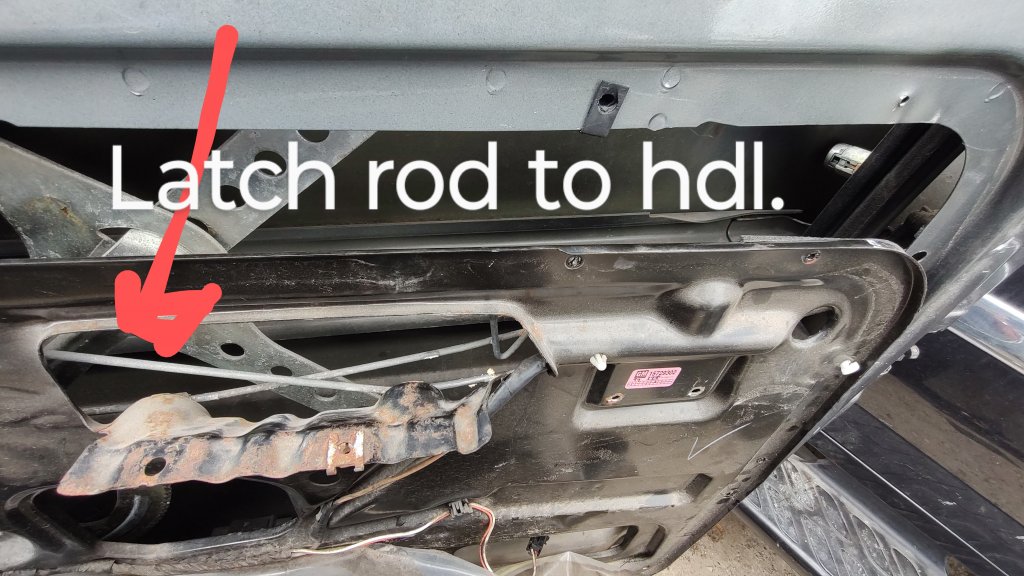

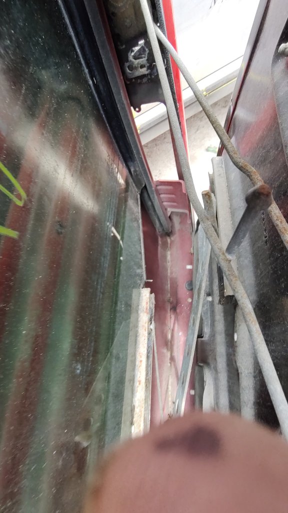

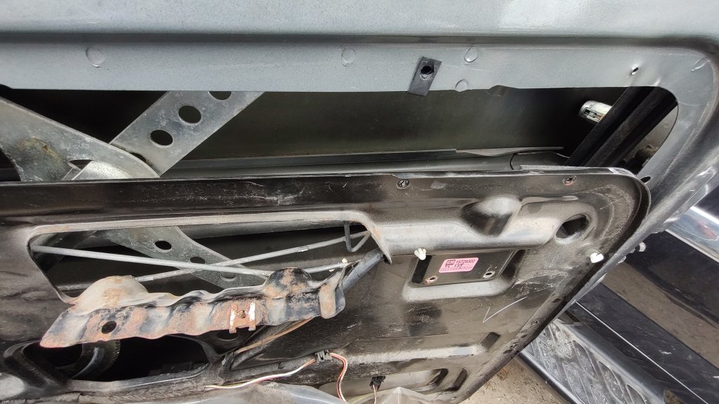

The actuators can get stuck in the Lock or Unlock position. Maybe yours is in the process of going out? I think there is a spring inside it that the solenoid uses to pop the plunger?
I had this happen on my C3500 OBS Crew Cab longbed; what I did to make the locks work manually was go into the door and pull the lock rod out of the actuator. There is a short bar that goes from the horizontal lock rod, vertically into the actuator plunger arm socket. You could probably cut the bar off, but it's hardened steel and I wanted to be able to have functional power locks after replacing the actuators.
Unfortunately it's been too many years since I've been inside a square body door so I don't know how similar it is to the newer trucks. Maybe these pictures will explain more?

It could be a dying actuator that can no longer fully pull the latch into the locked position, poor alignment of the actuator and/or linkage or just a weak power feed to the actuator.
With the fact that it does so even when the power isn't connected, I'd start looking at the linkage first.
