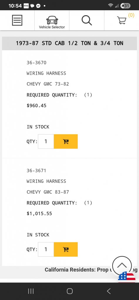

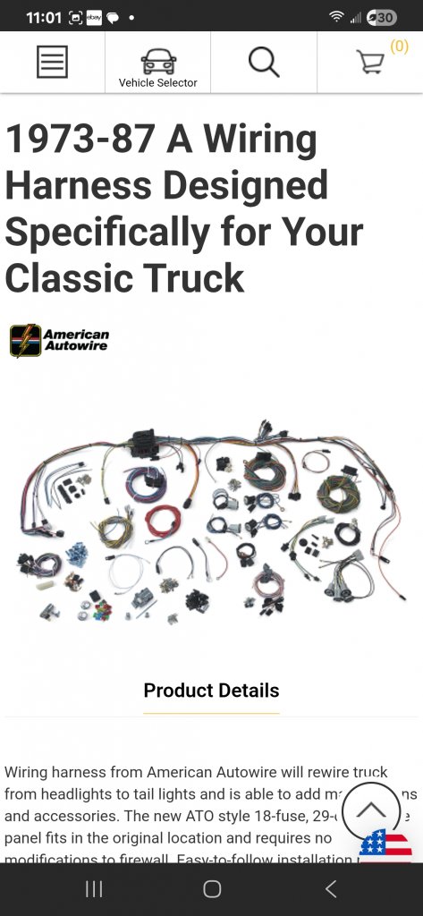

New harness on order
squaredeal91
Mar 10, 2023
3,118
5,891
Cave junction Oregon
Greg bush
1991 SB
5.9 Cummins 12 valve
I felt the same way lol. But won't have to cut, solder and shrink everything this way. It seems to include all the switches too though. Everything plug and play like original.

AAW makes excellent harnesses.
