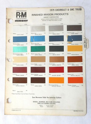

There were three patterns conventional, special, and deluxe.
In these colors.
Clearest ones I could find
https://www.paintscratch.com/ is where I get my paint from, they have the colors listed with code and better examples.
Mine for example was ZY2 for conventional two tone than 65L with 65 buckskin 60 Santa Fe listed in the description I don't know if specific combos had codes
here is another 1979 chart with better scans of the names of GMC/ Chevy.
.and some such look similar,...so after 45 years of sun and any possible body panel transfers from similar, Carmels and Saddles may look a little bit similar,...so one would have to color match newly made paint back to what was the original desired color with something unseen by daylight. like inside the cab

Went to paint store and got a quart of Neutral Code 60, same as the RM chip card shown. Thanks for the help
