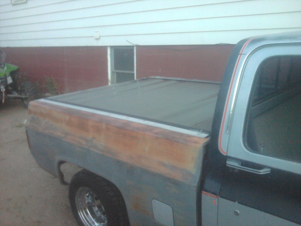

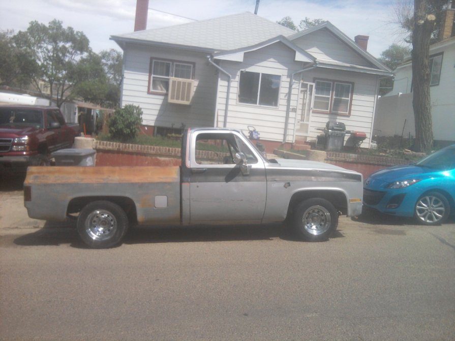

here is the truck after I did it
Question totally off topic here where did you get that bed cover I would prefer a fiber glass one but a leather one would be ok too. Nice truck and looking good. Thanks for the pics too

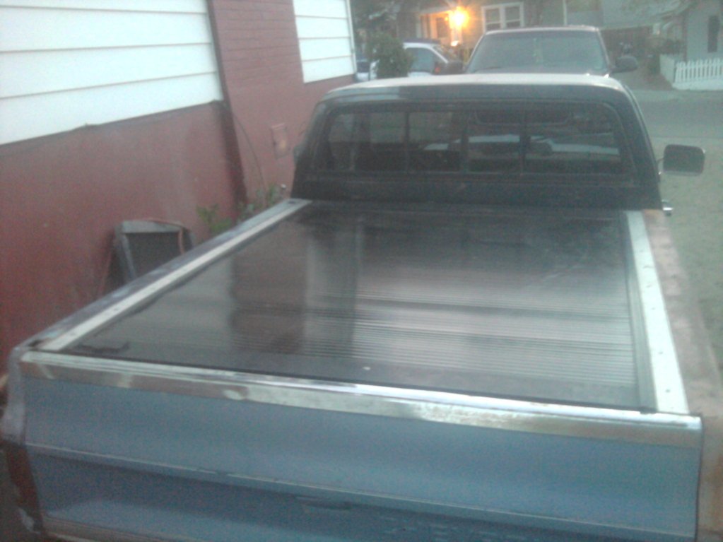

a buddy of mine got it used and made it fit a square short bed by using 2x2 aluminum angle to space between the bed and the cover. in this pic you can see the 2x2 angle the cover is screwed under it you can see the screws in the middle of the 2x2 angle piece
he has no idea what it originally was on
it is almost the perfect length so I have thought about measuring a few newer trucks until I find the right length and a close enough width and get a cover that fits what ever it was
Thanks I'll be on the look out for a cover now
