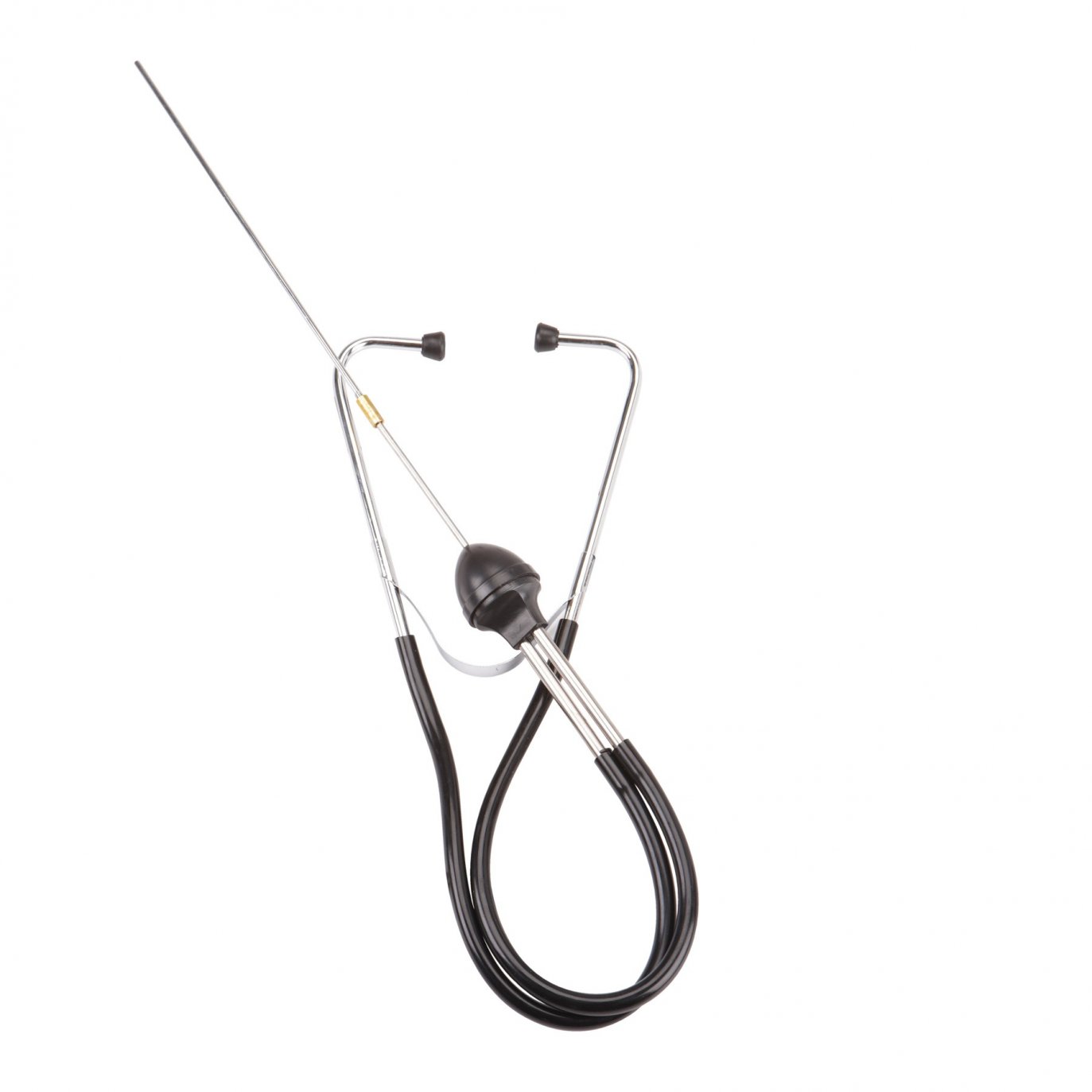

You can also get a $2-$3 cheap but very effective stethoscope from Harbor Freight and start touching components with the end of it. A long screwdriver with the handle to your ear, or even a sawed off broom stick or shovel handle can do the same thing. Put your ear to one end of the handle and touch the alternator casing with the other. Closest to the front of the alternator where the main front bearing is would be best. The sound will travel through whatever your touching it with. If you can reach in there with the motor running, and ever so carefully not to get it caught up in any moving part, you can also put whatever you're using on the timing cover or get under the truck and even on the oil pan.
You'll either have to chase the noise down, or find it by process of elimination but it can done.

Sorry haven't got back to you guys. Pretty sure it's the timing chain making the noise. Bought the stethoscope and listened to a few things. I can hear the sound in the timing cover as well as another sound like the chain is hitting the cover itself. Now the question is gear drive or double roller.
