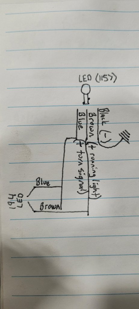

I'm at work so this is as good as I can get for now. Grounds are good. Bare metal, clean, I went the extra mile to clean up all my grounds because I know how picky they are.

I highlighted a part in your pic, does the blue wire connect to the brown here?
No sir, just the way I drew it, added the 194 just as reference at the end.

There is a problem with your diagram, it shows 2 Positive feeds to the 194 bulb, and no negative connection. I learned from doing the LED conversion on my son's truck and a 2006 Jeep, Incandescent bulbs don't care about polarity, LED's will NOT work correctly if the polarity is not 100% correct.

@squarebodysteve86
1. Easy fix, disconnect the shared lead from each respective fender marker light and it's turn signal feed wire. Add a ground to that wire on the 194 bulb. Seal off the wire to the 1157 turn bulb.
Yes, now the side marker will only work when the parking lights are on, they will not flash with the turn signals. No more feedback problems.
The diagram for this sentence is correct. No the blue wire is not connected to the brown wire. The 194 has two positive feeds, read on.
This posted before to explain it all:
2. Why LED’s may not work well in GM fender marker lights:
First you need to understand that the fender 194 bulbs do not have a dedicated ground. One contact is wired to the positive parking light wire, the other contact to the respective turn signal wire, (right or left).
This is how they work without a dedicated ground: If the turn signal is off and the parking lights are on, current from the parking light wire through the 194 bulb then follows the other wire to the turn 1157 bulb. Current moves through the turn filament of the bulb to ground. The 1157 bulb does not light because the filament requires more current than the 194 bulb lets through. The same is true if the parking lights are off and the turn signal is on, the parking light filament becomes the ground. So if the parking lights are on, then you turn on the signal, the 194 bulb blinks off, and both contacts of the 194 bulb have current and no ground.
So of course the side marker will never work if the 1157 bulb is removed or burnt out or have a bad ground. Keep in mind at this time current can be moving in either direction in the 194 marker bulb.
Electricity 101: What is an LED? = Light Emitting Diode. What is a diode? Many kinds of diodes but we’ll keep it simple. A diode is a check valve, only lets current flow in one direction. So how can a 194 replacement LED bulb even work? Current needs to flow both ways? The bulb has a transistor!
What is a transistor? The simple definition is it is an electronic switch. The switching transistor has four connections, two from the bulb socket contacts, the other two connections to the LED. The transistor senses which way the current is flowing and directs it to the proper connections of the LED. This transistor in the 194 LED replacement bulb is very small. The transistor originally thought to be needed only a few times, depending which way the non polarized 194 bulb was installed.
So when used in a GM fender application that transistor is switching all the time. The transistor only signed up to switch a few times. Now it is switching way more and it says, “I didn’t sign up for this, I’m out of here...”
Any questions?
