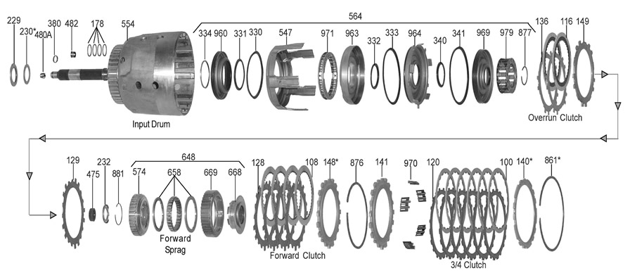

I know what you're saying here. I really wish it were sprags, but actually it's roller clutches in the books IIRC, which are much weaker than sprags. It's a nit picky difference in lingo I know, but if the guys who aren't transmissions guys go looking for sprags in the book, they'll likely never find it, so being politically correct, roller clutches.
This is also why when diagnosing transmissions, you also use manual selected gears. Many are not aware that using manual selected gears uses a different fluid circuit and actaully uses a different method to create the gear. Same goes true when diagnosing a band. You might have 2nd this way, but not have it this way. Whichever way you have it and don't have it can tell you if it's a band or not. Bands actually aren't used near as much as most think. I'd have to look at a flow chart since i don't momorize that stuff since different trans models are different, and the minute you think you got it, it's no wait, that's the Th400, not the Th350 or vice versa.
A good example of this is when you're in D and the trans is in 2nd gear. When in D and trans is in 2nd gear, drop it into manual 2nd gear. It'll feel a bit like it downshifted, but NO it didn't. It changed the routing of how it's getting 2nd gear. At any rate, good point to bring up Jake.
Got pics so I can comprehend that better?
