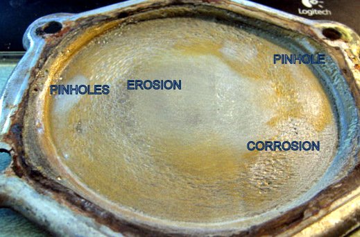

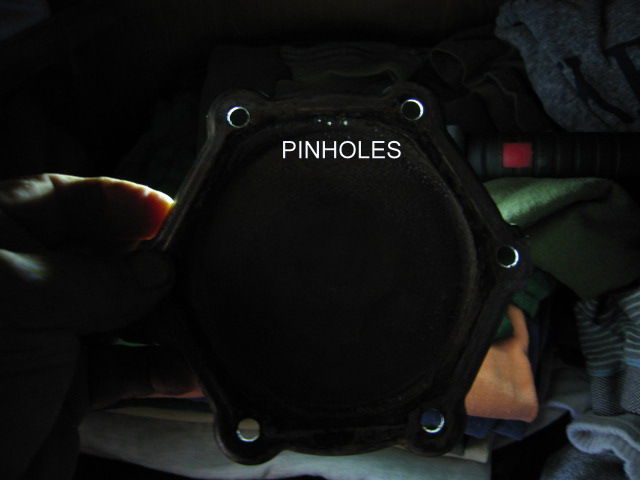

racerboy9
Sep 20, 2023
Athens, GA
Randle
Chevy K10 4x4
Pulled the pump and same back plate problem as my last one. Erosion, corrosion and pinholes. Always had anti-freeze mix. I could just put a new back plate on but given the work involved it seems better to get a new pump with a more heavy duty back plate. Most of the new pumps tout being "high flow" but I don't really need more flow.
