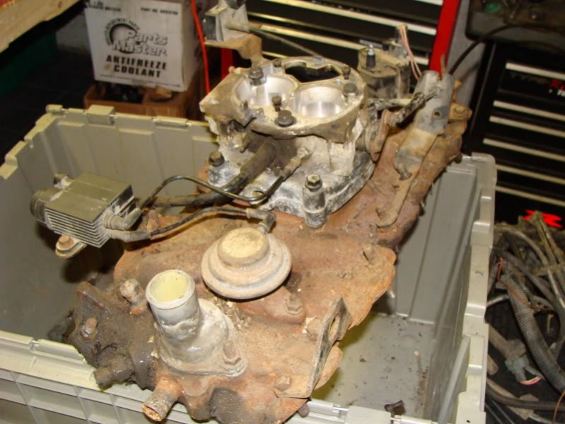

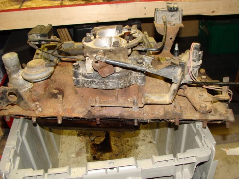

ya a tbi 4.3 v6 350 and 454 can use the same harness might have to adjust the length of some wires.
I put a 454 in my 90 suburban and used the 350 harness with no modification
I went to the junkyard and got the brackets that bolt to the intake for the sensor things off a tbi 454 and the tbi and spacer
I fired the 454 in the sub but never put exhaust on it and never really finished the motor install. so there might be a couple small things I may have missed but the 350 harness will for sure work.
and as long as your 454 has a stock or mild cam it should work fine
I just searched for these pics to show what you will need to get found the on the web so not sure what year the parts are
