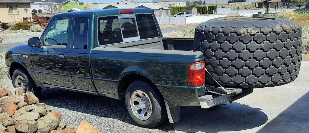

There, probably, is going to be run off from rain and snow. How much, I don't know. Of course, every situation is going to vary. Some of that is going to contain heavy metals.
If it's a large enough garden, my money is on that any contamination that occurs would be limited to the perimeter, where the fencing is.
To minimize the potential for contamination, and aside that many don't like the idea of food grown in tires, I'd consider doing what I do as much as possible anyway - grow in truck, tractor and combine tires. In your case, at least around the perimeter (it's addictive, not having to bend over to tend the bottom of maters, or for harvesting).
