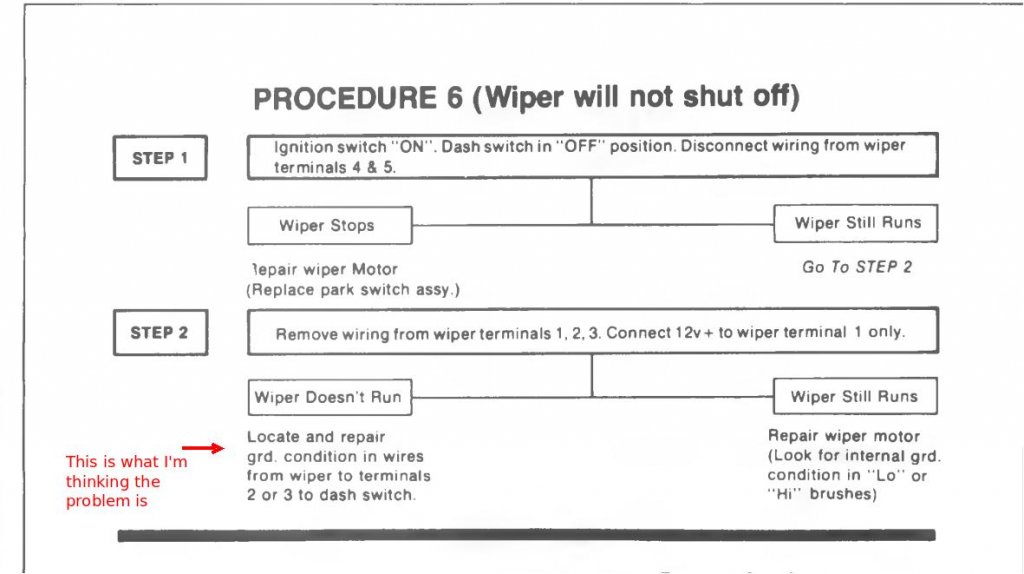

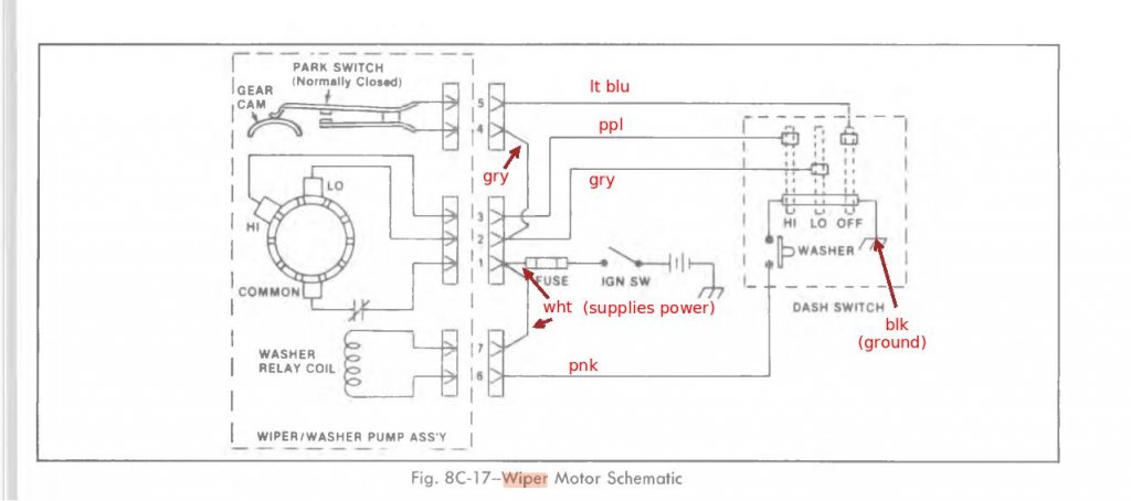

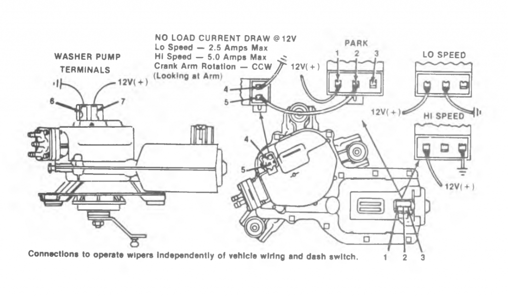

I have heard that the switch is ground and the motor should always have power to it?
correct.
attached is a simple diagram of how it works.

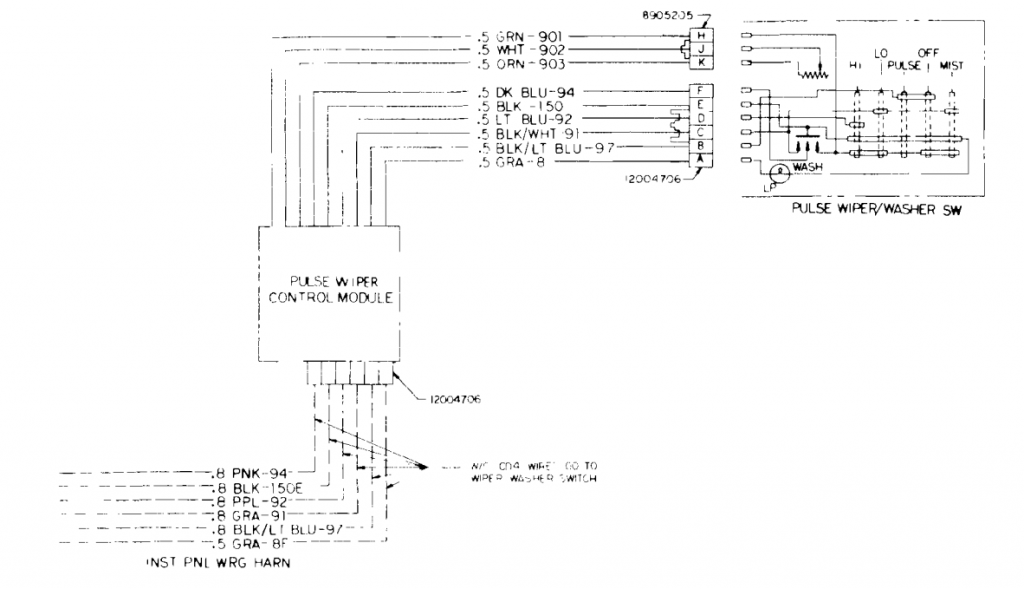

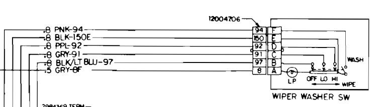

That sounds correct. Basically you are removing the delay module. "little box".
Attachments show wiring for delay module & no delay module

OR one of the wires (purple or gray) could be grounding somewhere before they get to the switch.
Does the washer work?
If you unplug the wires from the switch do the wipers still run? If they do not run, it is the connection to the switch or switch itself that is the problem. If they continue to run you probably have a wire that is grounded somewhere.
Attachments are how to diagnose. Notice the terminals are labeled 1-7 on the picture.

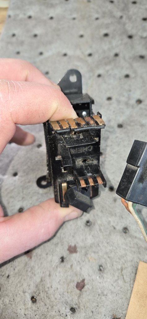

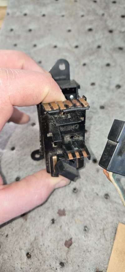

These are the module and switch both look melted, main reason i wanted to replace them.

I had constant continuity to ground on the purple wire by the motor. Un plugged the switch and lost it. So I pulled the switch out and the copper contacts where the plug pushes on are all messed up. Then I looked at the truck side and those pins are all messed up. Anyone know where I can find a new plug?
Jgonick
Jan 12, 2017
448
574
West Texas
Joel
What do you mean exactly by messed up? Bent or plastic is melted etc..
Picture would be helpful. You have a few options- I generally just try to replace the pins (they will usually come out of the connector by pressing on a tab- every pin is a little different on how to remove them).
If the plastic is melted- maybe Ebay or junkyard. Someone else might have a better idea where to find one.
It's been a while and I can't quite remember exactly what that connector actually looks like.

The connections in the plastic plug are all bent up. I'm having trouble uploading pictures. Yeah I think the plastic is ok but the pins are bad.

I just went thru the same thing, that plastic plug-in on the motor housing marked with wires numbered 4 & 5 was the culprit.
Yes, the motor is "ground switched" and is powered all the time the ign. switch is on. If I remember, I had to bend the contact out a little as it rides on a cam inside, that opens up that contact to stop in the park position.
