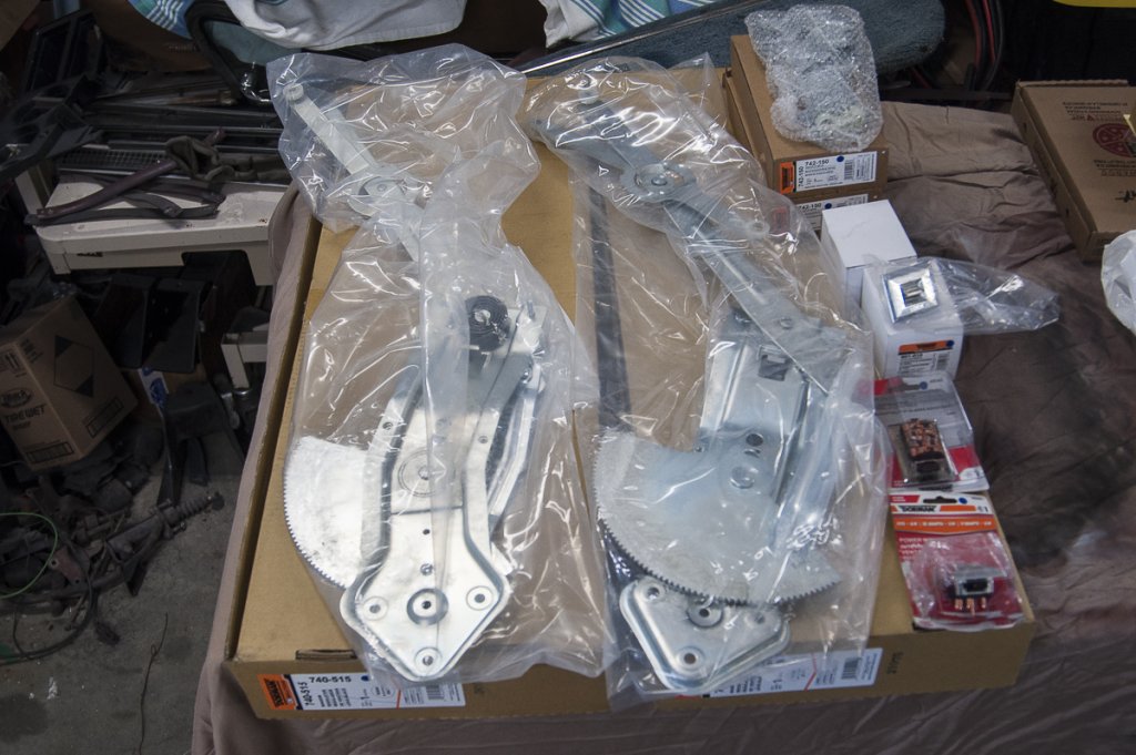

I put new seals in too and the windows struggled. Replaced the switches and new motors huge difference! The new motors work much better then the old ones.
same here! :)
