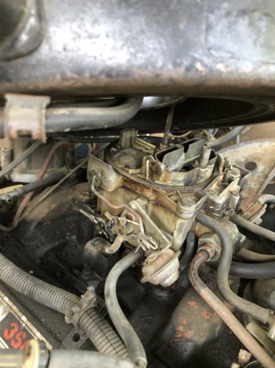

Alrighty, I grew up wrenching on my dads 1979 el Camino, which became mine for a time. Lots of hrs invested and lessons learned. However, this qjet has me baffled. I get that heat from the manifold will transfer to the choke but how the hell do I adjust it? Haven’t seen it before!
1976 k10 camper custom 5.7

Bend the vertical rod, the choke pull off is adjusted the same way. Is it too rich or lean? Choke plate should completely close until started.
