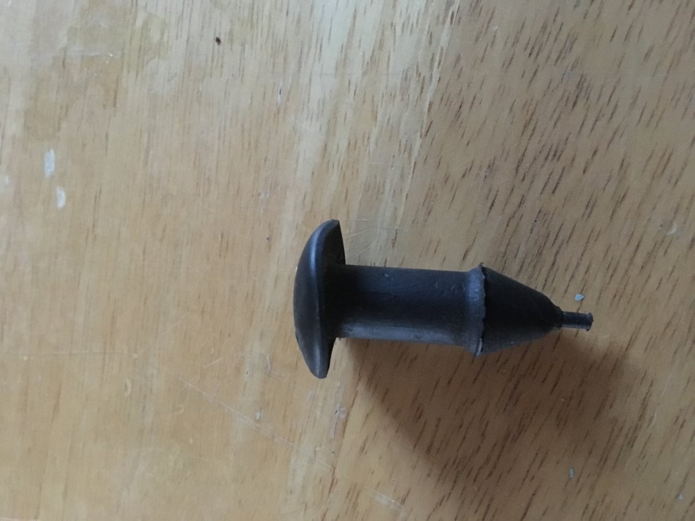

What is it?
CRM

Found it behind the seat when I pulled it to replace the upholstery.

I think it holds the sound deadener pad to the firewall down by your feet.

Yep, that's what it is.

A little tip about these fasteners - lesson learned:
If you intend to reuse them, don't try to yank them out from inside the cab. Give them a little drink of WD-40 and push them through the FW from the engine side with a pair of needle nose. They are pretty weak after all these years and they break easily:

Thanks guys. I'll find out where it's supposed to be and reinstall it tomorrow.
