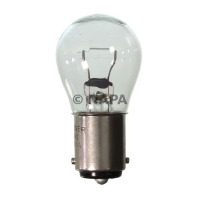

As it says, what bulb do I use for the stock cargo lamp? The one I pulled was an 1142, but that is nearly impossible to find. Would something else work in its place?

Napa has them - $1.35:
Part Number: LMP 1142
Product Line: NAPA Lamps
Attributes:
Bulb Base Type : Double Contact Bayonet
Bulb Lumens Rating : Approx. Max Candle Power Primary 21
Bulb Type : Miniature Lamp S-8
Electrical Rating : Design Volts Primary 12.8
Lamp Candle Power : Approx. Max Candle Power Primary 21
Overall Length : 2" / 51 mm
Volts : Design Volts Primary 12.8
Watts : Design Watts Primary 18.43
Miniature Bulb Candle Power Rating : Approx. Max Candle Power Primary 21
Miniature Bulb Electrical Rating : Design Volts Primary 12.8
Miniature Bulb Type : Miniature Lamp S-8
Important Information:
OE Type
Bulb Option 2

It has two contacts, I'm just curious if I can use a more common bulb (think sylvania silver or whatever) instead. I'd like to get a bit more light out of it if possible. I'm having a hard time figuring out what is compatible.

The bulb used for the back-up lights (GE # 1156) has the same base configuration and a higher output.
Warning: If you decide to use an 1156 in the cargo lamp, watch out for overheating the of the lens due to increased wattage (18.4/26.9).
Product Code 1156
Watts 26.9 Watts
Volts 12.8 Volts
Base Type BA15s (Single Contact Bayonet)
Bulb Type S-8
Rated Average Life 1200 hrs
Candle Power 32
Filament C-6
Bulb Finish Clear
Max Overall Length (MOL) 2.000 in (50.8 mm)
Light Center Length (LCL) 1.250 in (31.8 mm)
Order Codes 1156
Product Code 1142
Watts 18.4 Watts
Volts 12.8 Volts
Base Type BA15d (Double Contact Bayonet)
Bulb Type S-8
Rated Average Life 1000 hrs
Lumens 264
Candle Power 21
Filament C-6
Bulb Finish Clear
Bulb Diameter 1.000 in (25.4 mm)
Light Center Length (LCL) 1.300 in (33.0 mm)
Energy Star Rated Yes
Order Codes 1142
Konas new ride
Feb 18, 2013
791
49
Alberta
Gerald
If you do melt your lens you can still buy a new one at GM.. for 25 fricken bucks.. Stay with a lower watt build and add a under the box rail light..

If you want brighter get an LED bulb
Sent from my iPod touch 4th Gen using Tapatalk
47,210
9,487
And then you don't have to worry about the lens melting either. :waytogo:

Got my led bulbs off of amazon since I was unable to find one local. Also added a clear lens from LMC.
