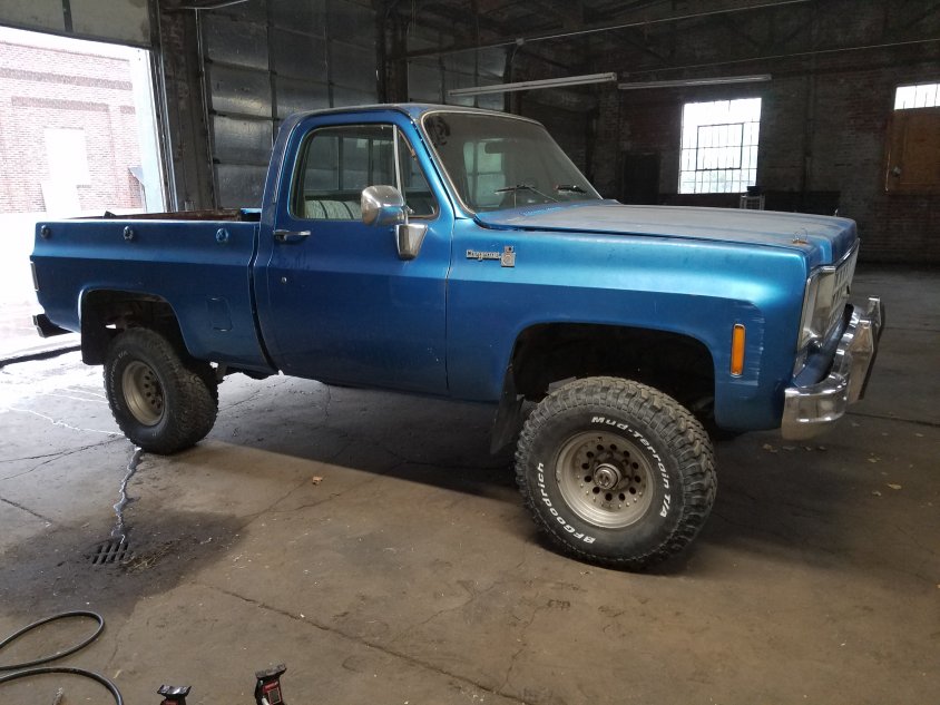

so my mirrors change position every time I shut the door. on top of that they're pretty cracked up and just look big and ugly. what are you guys doing for different options on mirrors?

There is a #2 Philips head screw on the bottom of the mirror. Tighten it and see how much you still hate the mirrors.
You have a screwdriver, right?

Acutally, loosen that screw to allow you to pull the stainless cover up. It's been awhile, but I believe there is a spring clip that helps hold the cover on once the screw is out. You may need a screw driver to pry up on the bottom of the cover. Under that you will find bolts that tension the mirror shaft.

haha wow tons of info... ya I never bothered to look to hard into how to fix the ones on there. Im pretty sure the guy that had the truck before me used it as a hunting truck (maybe), but the glass is all cracked and deep scratches all over em... I was just checking to see if there were other styles you guys personally ran

Places like O'Reilly Auto Parts sells just the mirror lense for this style mirror. Several square body suppliers sell replacement mirrors in chrome or stainless ($25-$30 ea). LMC Truck is the only one I know that sells the wide angle right mirror.

Pop the cover off and tighten the 2 tension bolts. $10 for new glass at the local parts store.
