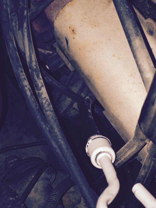

Okay, okay. I screwed up. That looks like the early fuel evaporator (EFE). That guy hooks into the thermal vacuum switch (TVS) on top of the engine, which hooks into the AIR Valve. At least it does on the 305 in my Caprice. It's supposed to warm your fuel up a little to help with cold engine operation. However, it's a catalyst component, and it was unplugged for months on mine until I put it under the scrutiny to find every little vacuum leak. It ties into the AIR system, and you can delete it along with the other so you were right from the get go. Here's a picture of mine on the car. It's the little can under my freshly rat-eaten, brand new Delco spark plug wire.

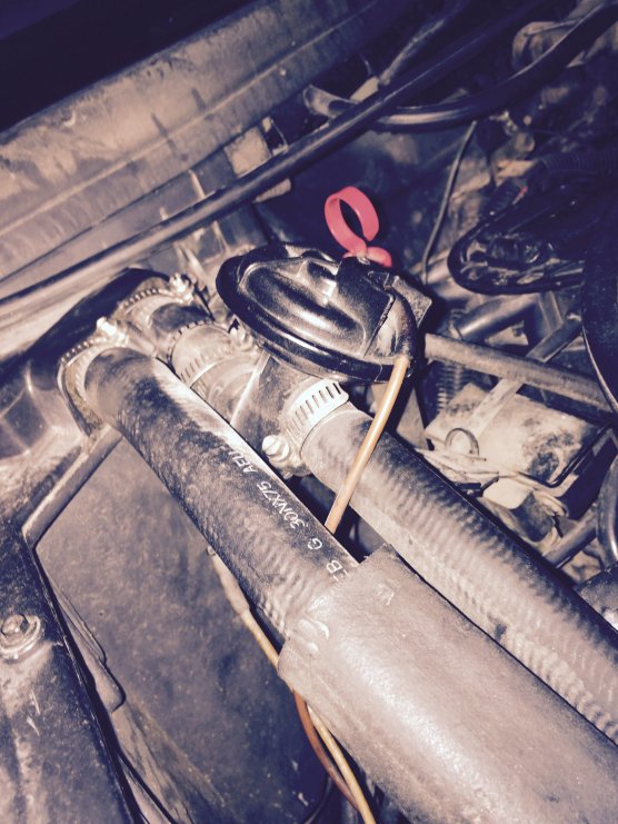

I had it confused with this HVAC actuator. Now that's a whole different can of worms. Does your blower work? Do you lack certain fan speeds? Do you lack certain climate control modes? Does it blow weak? Or does it just blow hot?

This thing. Whoops.

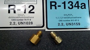

Verify the refrigerant type by looking at the fittings unless you're already for sure it still has R12 freon. You may be able to just get a can of freon from Walmart and take care of it yourself if someone already converted it.
