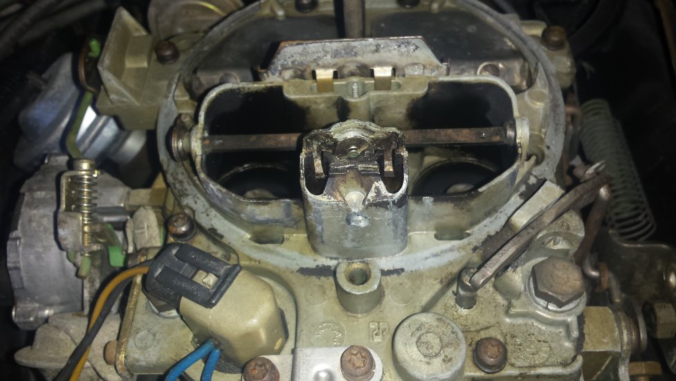

Hi all-
New to the forum and squarebody GM trucks. I've always love the 80's suburbans. The other day, o finally got a 1986 half ton with the 350. It's a California car, so emissions have to be met. The car had a blown head gasket, so I didn't do a very thorough inspection under the hood. However, when the tow truck driver dropped it off, I looked it over and noticed the choke plate is missing! I took a pic, and I'm wondering if anything else looks like it's missing as well. I'm a forklift mechanic by trade, and I've rebuild a couple carbs (a two barrel varajet and a thermo quad). I'm just not familiar enough with these to identify missing components. Thanks in advance for any help offered.

So you've got to get this thing to pass before you can even change title to your name right? So are you going to replace the head gasket before inspection I hope?
Obviously you have the CCC (Computer Command Control) Carb being that it has the A/F mixture solenoid in the carb. That's not a cheap carb. You're pic is cut off, but is there also a plug near the accelerator pump? That'll be the TPS (Throttle Position Sensor).
