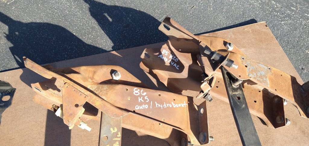

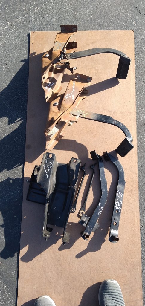

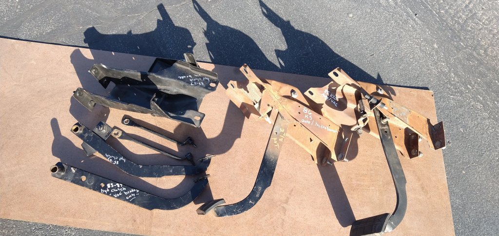

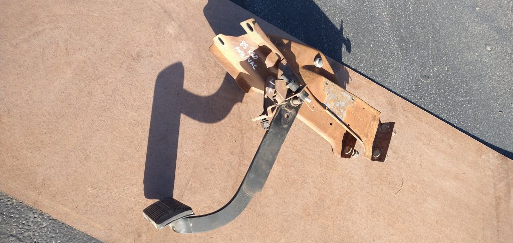

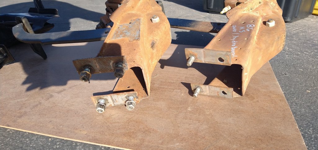

I got all 3 variants but the manual/ hydro is in the truck. Took a few pics tonight.

Thanks! Looks like I'll need the single wide pedal one marked "K20 Vac. Boost". PM sent. :)
