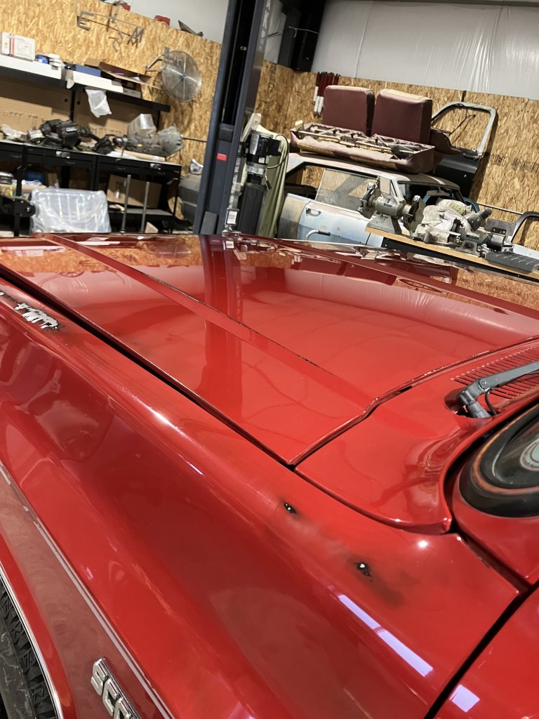

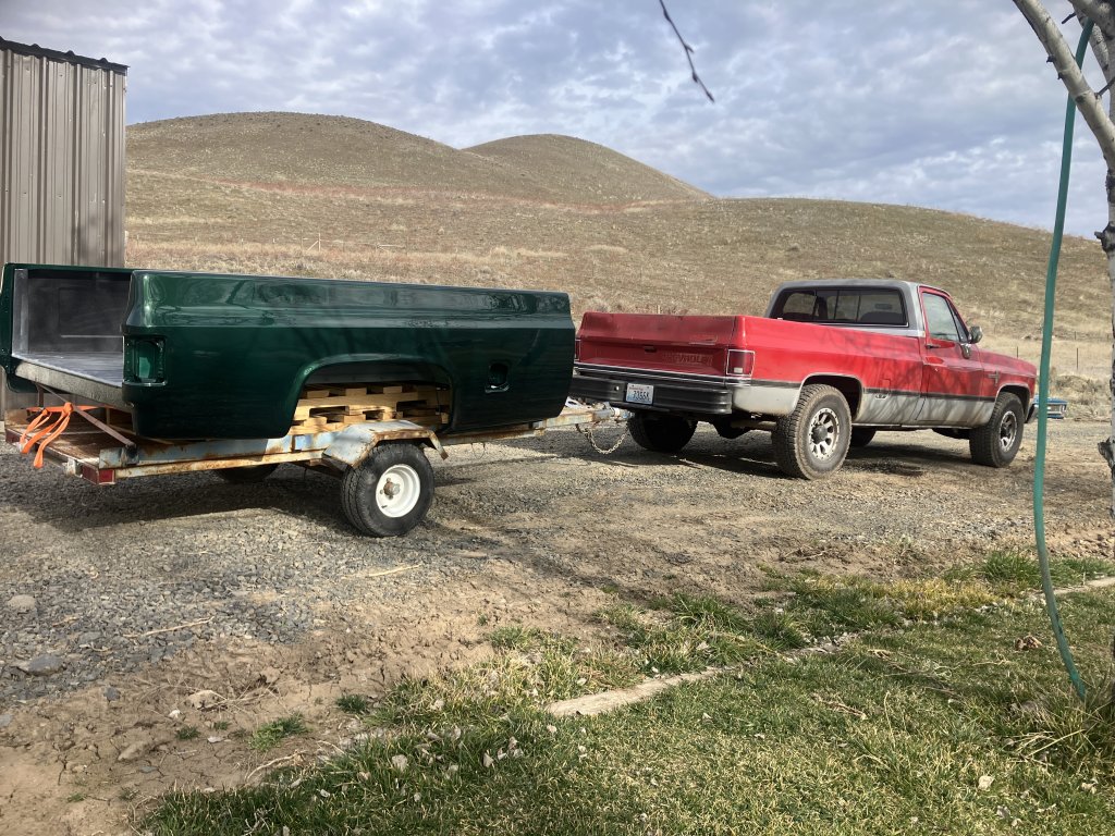

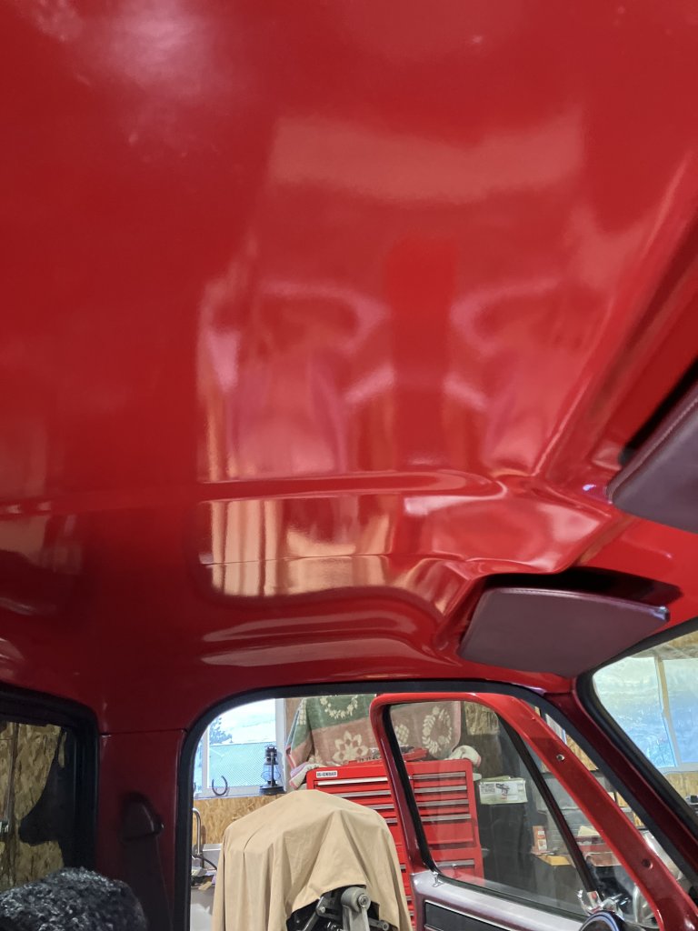

I bought two Milwaukee buffers, a small and a large. I wash often, wax about three or four times a year, and things look good. On the K20, just got the box painted, six base, three clear. Single stage works fine if you put it on thick enough so that it can be colorsanded, then keep it waxed. Waxing is the key.
