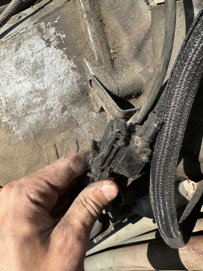

Hello! I’m currently Doing some work on my 86 k10 swb with the cab and bed off. After pulling the cab I found A switch zip tied to the transmission dipstick. 700r4. It appears to have two vacuum connections on it, but hasn’t been hooked up for a long time. Its wires connect into the harness that goes to my transmission plug. I thought it may be the converter lockup of some kind but that’s near my brake booster. Any thoughts on what this is for? I will take a better picture tomorrow.

K get us better pics tomorrow. In that Pic it looks like the egr bleed solenoid.

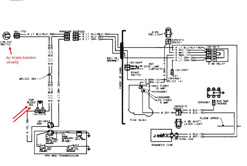

Are both vacuum switches in place on the firewall? There should be 2 . One for converter lock up,in for ignition tip in. In that Pic it looks like the egr bleed solenoid.
EGR
see attachment:

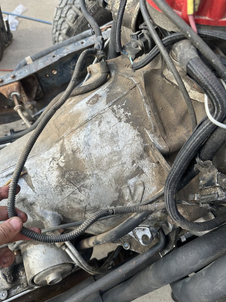

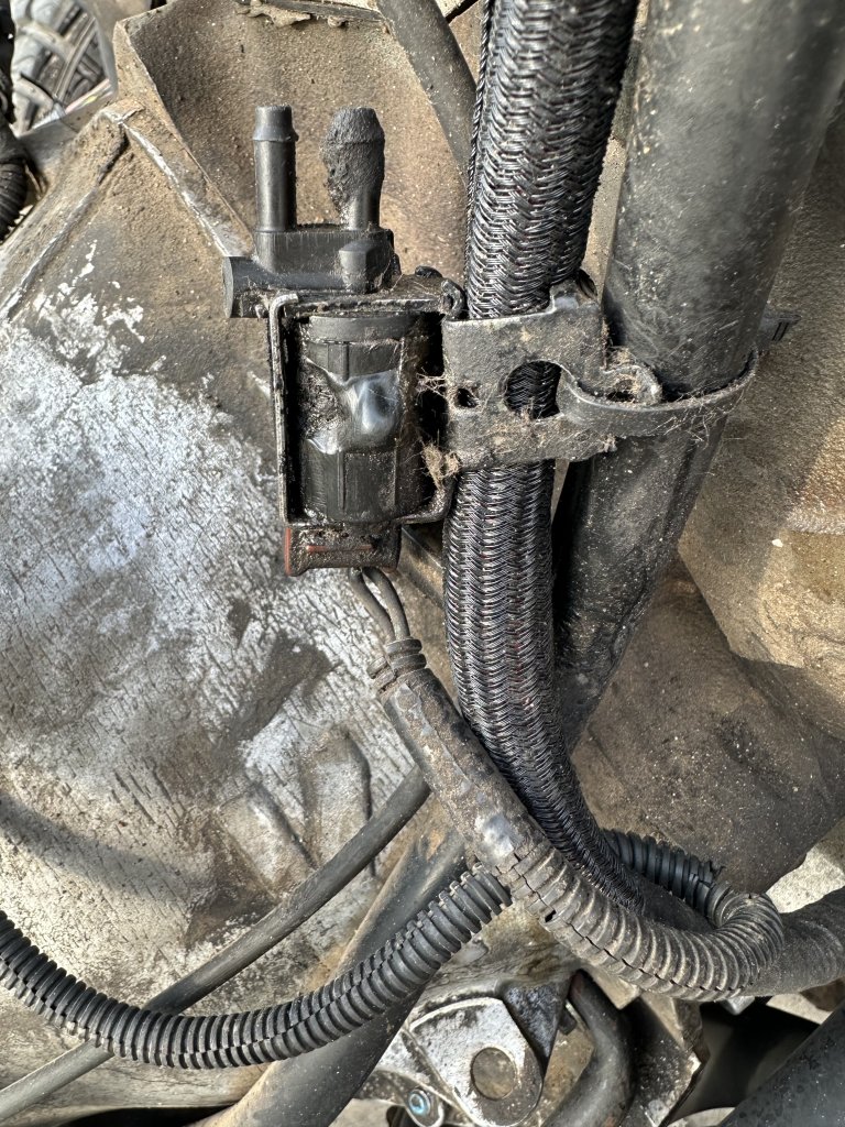

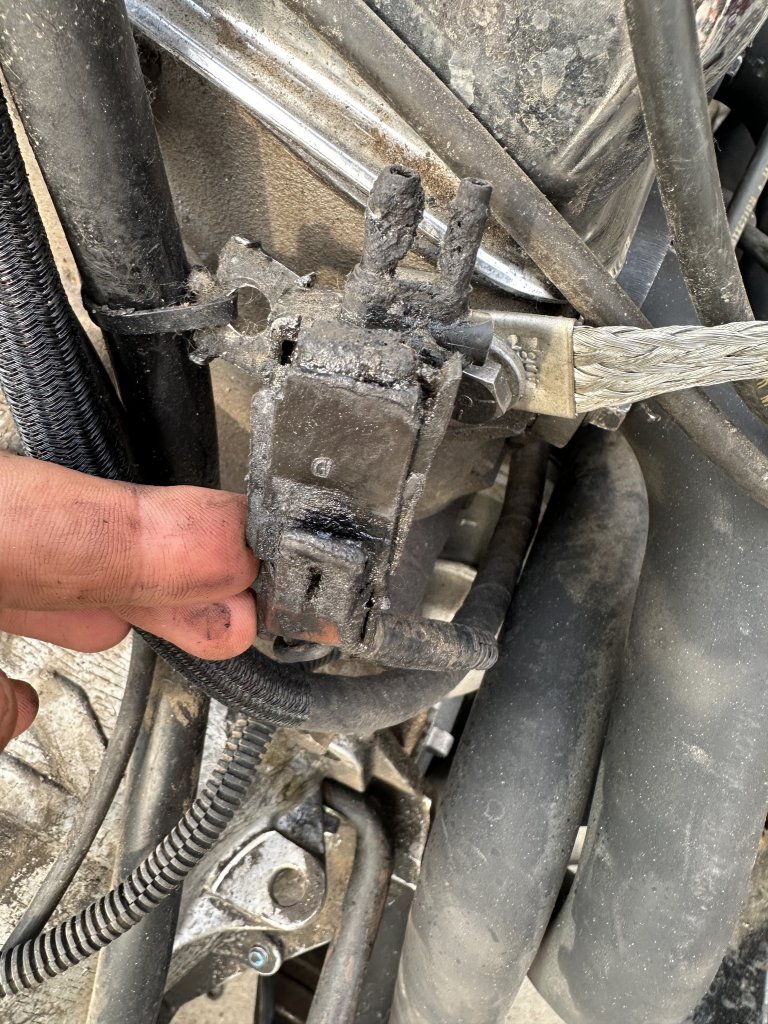

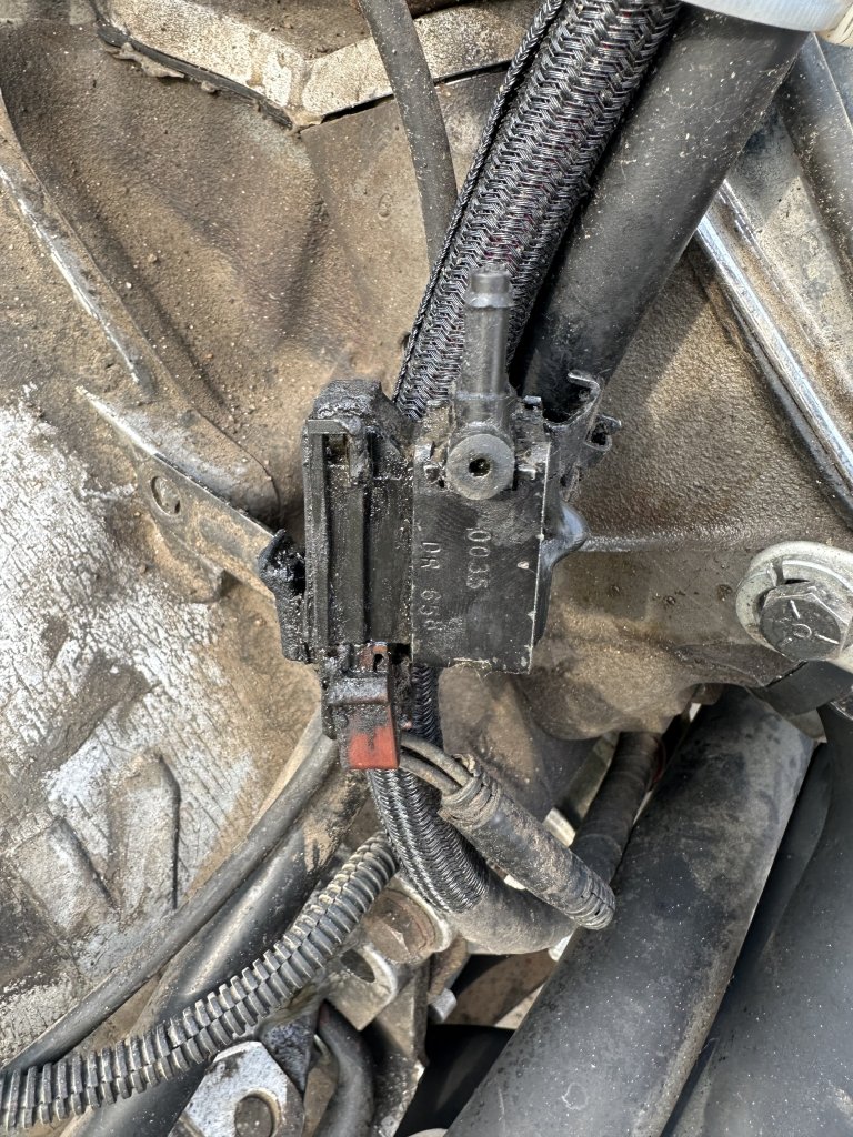

That seems to be it, the Wires running to it are yellow and Light blue. Thank you. I’ll cut it the rest of the way out.
