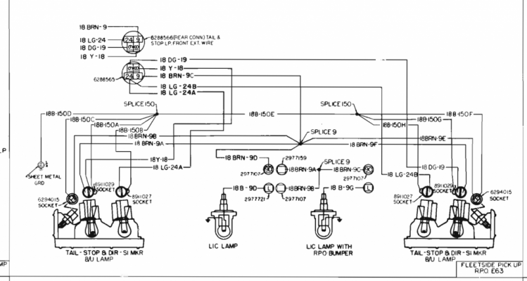

Got a new bumper, disconnected all wiring, splicing off trailer wiring, adding new liscense plate lights to constant brown. All was well, then no right rear turn signal.All bulbs are good, running lights work there, but no flashers or turn signal on that side. Dark green feeding in from rear harness looks fine, re spliced together along seam, so I don't know. Fuses good and all other lights. Thanks for the response.

Most turn signal issues are due to poor grounds or missing grounds at the light housings, the wiring loom up under the rear bumper not grounded, or one of the two-conductor signal bulbs is inserted with the wrong orientation. Also check your instrument panel ground up under the dash.
double check this.
and obviously check the bulb socket & bulb (make sure both filaments are good)
I''m assuming brake light does not work on it also- correct?

All I did was tap into the brown for liscense plate lights, brown being running lights and side markers. Those still work. Trailer wiring has been spliced off for months, no problem. I took the liscense plate lights back off, and no change. I assume I bumped something, so I was looking for help as to where the grounds have been disconnected, ect.

Rear harness under bumper has been the source of past problems, hence the trailer harness delete. I'd think grounds would be the source of trouble here, I'll look into some diagrams.

Thanks for the diagram. Much appreciated. Fresh bulb, and brake is also out unfortunately, so most probably a ground issue. I'll check andreport back

Okay I didn't understand what you meant disconnected all wiring splicing off all trailer wiring. Sounded much more involved than tapping into 1 brown wire. If your lights worked right before go double check everything you did. Taillights work so not a ground issue.
