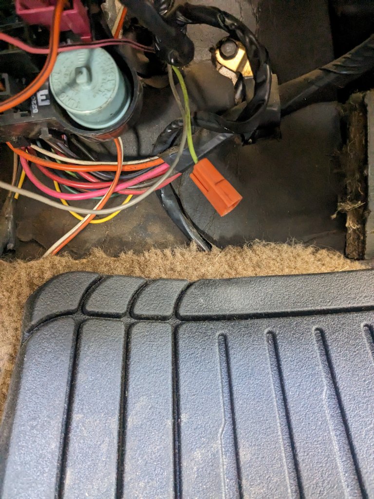

Also, there is a solo wire under the dash next to the flasher just looking to be plugged in somewhere!?!

Thanks again for the direction and I still don't know what that wire under the dash is for, haha!
